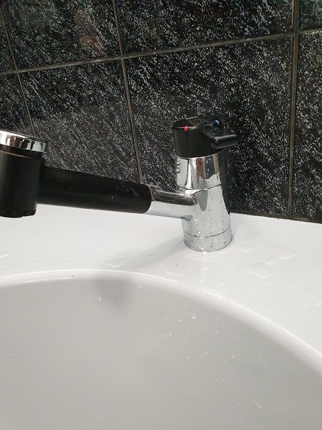

I have a spa with a Mamoli tap, however it is leaking whenever I turn it on.
I want to fix it or replace it but don't know how to remove it from the spa. and I cannot see any screws around it
Please help.

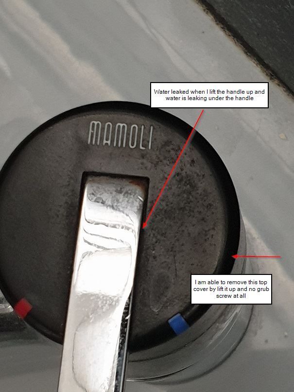

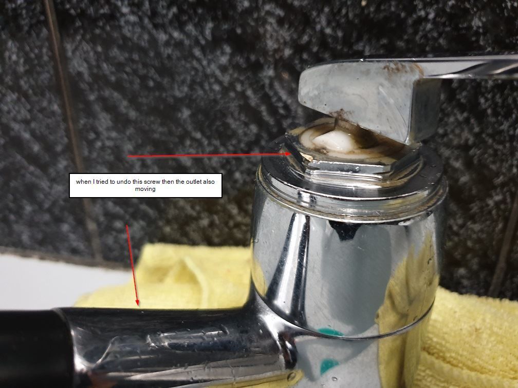

Hi, I am able to remove the top plastic cover by lift it up and no grub screw. I am trying to undo the big screw but when doing that I found the water outlet also moving. I cannot unscrew more than half turn. Please help.
It looks like you've managed to remove the top black plastic cover @quynhpham55. The large nut you are trying to unscrew does appear to be the next step. What happens if you rotate the spout over to the right-hand side full extreme? It would have nowhere else to go and shouldn't turn anymore. Alternatively, I'd assume that you or someone else needs to hold the spout in position whilst you undo the nut. Careful that you top snap something in the process. Do you have any WD-40 that you could spray around the threaded section? That could help loosen the tap.
If you're still struggling, you might like to contact the manufacturer to see if they have some instructions available for the taps disassembly.
Hi, I did spray WD40 and turn the sprout to the right as you mentioned, but I still cannot unscrew the the big screw. I will try again later.
Thanks

"I am trying to undo the big screw but when doing that I found the water outlet also moving. I cannot unscrew more than half turn. Please help."
Hi @quynhpham55
I'm a lousy plumber but I have an unused Estilo mixer-valve which I took outside and 'played' with. It would appear to remove that hexed component it relies entirely on the anchorage of the tap - below the sink. I don't have this - so I viced the package end.
The spout spins 360 degrees and plays NO part in removing the mixer. Admittedly, mine is brand new and it offered no resistance in removing.
Clearly yours needs time for the WD 40 to soak - and maybe more grunt? An excellent lubricant is WD 40 Specialist Fast Release Penetrant - a little more expensive than the usual WD-40.
I used a 30mm rigid spanner for a good grip - I don't trust shifting wrenches on brass - I have stripped fittings.
To me - you can remove the lever in your photo and get the "ring" end of the spanner onto it - for a much better grip.
I can hear plumbers around Australia laughing at me! ![]()
That is interesting and very useful information @Noyade.
Usually older taps are stuck due to the build up of corrosion in the threads.
One way for @quynhpham55 to loosen it, after the WD40 soaking, is to use a well fitting spanner and tap the end of it in the direction to undo it (CCW).
Not a big hit... not trying to destroy anything here, but a short-sharp tap to break the grip of the thin build up of corrosion and allow it to turn.
(If it doesn't move it, bigger hits are not a good idea; instead respray WD40, wait again, try a sharp tap again. The initial tap will likely open up the corroded bits enough to let the WD40 get in further on the second application.)
