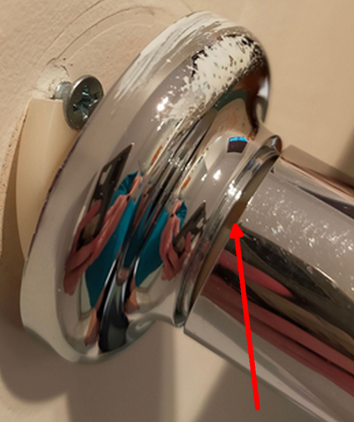

Hi all, I need some help and advise on how to fix or repair this towel rail on my bathroom... It snapped or break apart and I can see inside it seems to have screen and white thingy but unsure how in to repair or fix it. Any advise?

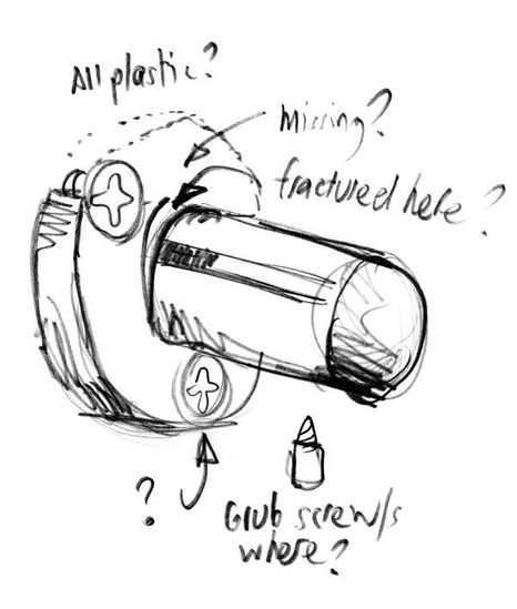

Just to complete the coroner's report - the entire fitting that attaches to the wall is made completely of plastic?
That chrome flange then fits over it?
Then the hollow of the rail shaft fits over the plastic protruding rod?
And then finally, it's all held in place by - metal grub screw/s? Into plastic?
To my eyes this is designed to accept countersunk screws - otherwise that flange will not sit on correctly?Coroner's InquestCoroner's Inquest
What is that dark 'channel' indicated - you can just see it between the gap?

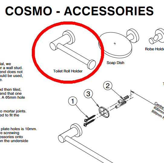

The installation guide for this model towel rack is available here:-
https://gwa-prod-pxm-api.s3-ap-southeast-2.amazonaws.com/pdf/41304_is883b-instruction-sheet-cosmo-ac...

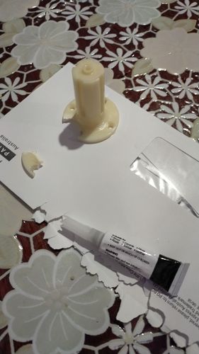

You will need to remove the grub screw, if you haven't already. If you can't get a new mounting plate it could be possible to repair the existing one, assuming that it is the cracking around the mount holes that are allowing it to let go of the outer shroud.  You could try a glue, such a Super Glue (not the cheap stuff, use this https://www.bunnings.com.au/loctite-2g-and-4ml-2-part-all-plastic-superglue_p1210073 ) to repair the cracks. If it attaches (depends on what the plastic is) then I would also run the tip of a soldering iron over the cracks to melt the plastic a little and form a stronger join. But if they hold well enough just with glue then use a small flat washer on the screws to spread the clamping force over a wider area than just a screw head size will.
While you are fixing things, I recommend removing the other end and putting washers and different screws there too before that end breaks for the same reason.
(If you can get a new backing plate then of course that would be preferable to gluing the broken one.)

Evening Ted @TedBear
To me - @calccom21 's wall bracket definitely appears to be plastic, cream coloured and with a plastic arm (just visible) protruding into the rail support arm.
Whereas the Cosmo product as seen in your PDF has a pressed metal wall bracket with protruding top and bottom lips that grab a notch at the top and secured with a grub screw at the bottom. Note also the screws are close together and in a vertical alignment - very different to @calccom21 's wall bracket above. They don't look compatible.
I can confirm the above as I have the toilet roll holder - which is a rubbish product.
Maybe @calccom21 can give as further details. I have no idea why the makers would have gone with a plastic wall bracket.

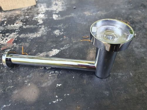

Thanks All. I finally fixed it.. might be easy for some but first time fixer here..hard to take it out..but what I did is quick fix with super glue and seem sturdy enough...and I think my plaster wall behind has wood support in as I need to unscrew and screw harder than I thought.
