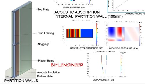

@antoallison
You will need to provide more information`
and will require proper CFD-acoustic simulations rather than cartoon GIFs, otherwise you might end up spending a bomb and the problem isn't completely solved

Got any cheap and cheerful DIY suggestions instead @BIM_Engineer?

thanks BMI - I am so technically challenged that I don't even know what a cartoon gif is ??

A Gif is a file format used on the web for short animations. I believe @BIM_Engineer was referring to the animated diagrams on the page that @MartyH linked to.
