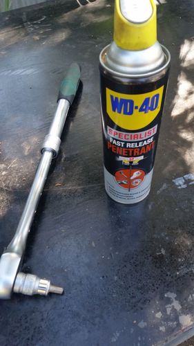

That's a fair size to safely use some external elbow grunt. Rather than go down the "best power drill" path I'd try a dedicated 1/2 inch 6 mm allen socket with an extension bar. Prior to this, squirt some of the new WD 40 Penetrant spray first.

A man of science the fulcrum principle
