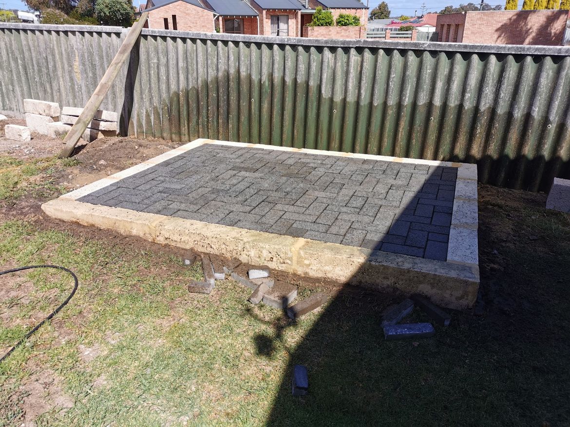

I recently did the same thing , i used secondhand pavers and limestone for the edges it cost me about $120.00 took a bit of hunting around
