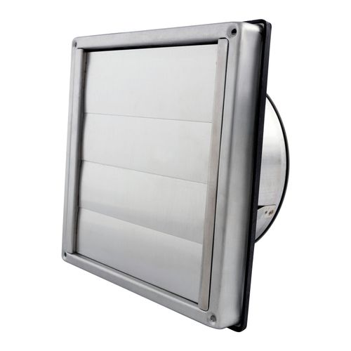

I want to put in a vent on the outside of my wall for fume extraction on my laser cutter. The question is how do I flash the vent into the corrugation sheet that is running vertically and water proof it?

The vent I'm putting in is this one https://www.bunnings.com.au/q-decor-150mm-square-gravity-vent_p0074119

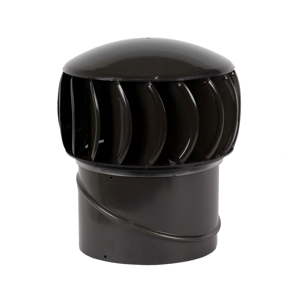

If you mean one of these in the side wall? Flahing kit supplied is for a roof mount and the design of the blades would not stop water if it is not pointing up.

no my bad I have fixed the main post with the correct link. However is this vent https://www.bunnings.com.au/q-decor-150mm-square-gravity-vent_p0074119
I found a way to do this, apologies for no photos as I didnt have my phone on me when I did it, will try and get some this weekend, however what I did was.
I cut the required hole the size of my vent so that it sat on top of the profile ridges on each side, however at the top where I need my flashing I cut up an extra 50mm length to suite my intended flashing in a retangular shape at the top
For my flashing I had some left over colorbond fence sheet so I cut this out in a square making sure It ended on top of the ridge profile. The width was slightly wider than my vent on each side and extra length that will slide up under the corrugated profile of my wall at the top of my cutout, that retangular bit extra I cut out for my vent. So the top of the ridge became the flashing for the top of my vent and slid the extra up under my corrugated wall in the hole I had just cut.
I then installed my vent up under the ridge, then secured and sealed as normal.
The ridge of the fencing profile forms a lip to prevent rain etc from getting into the top of the vent where its installed. On the bottom side of the vent I just bent up the corrugation like you would do for roofing.

I did look at those as I had used one previously for my wood heater, Unfortunately it would not have worked in this situation. The vent I needed to flash in on the vertical corrugated wall is the one shown below and doesnt really lend itself to that type of flashing.
Luckily the edges (left and right) both landed on a raised corrugation so sealed nicely there, it was the top that needed flashing to prevent any ingress of water, so in the method I outlined above using some fence sheeting worked well in the end and yes sealed with some gutetr silicon I had on hand. We've had some good rain and so far so good 😀
