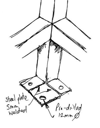

Pondering your problem in the present heat - I now feel if I was in your exact situation I would now ignore all my 'advice' I typed above. Once 'I' have positioned the frame and corrected the diagonals - I'd be welding pre-drilled plates to each corner so my rotary hammer drill has free unadulterated access, and to hell with the other holes. I would also be using concrete bolts.

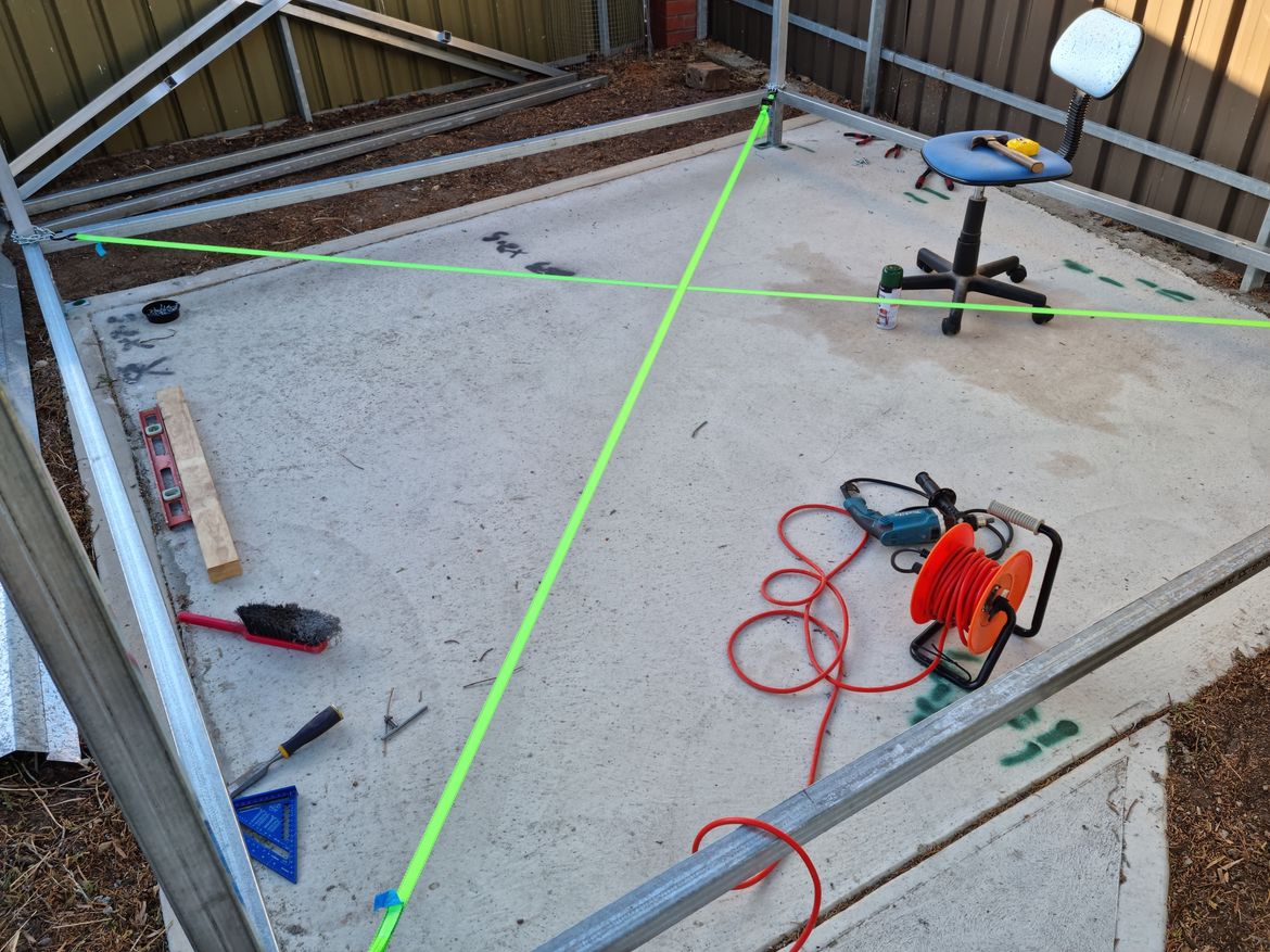

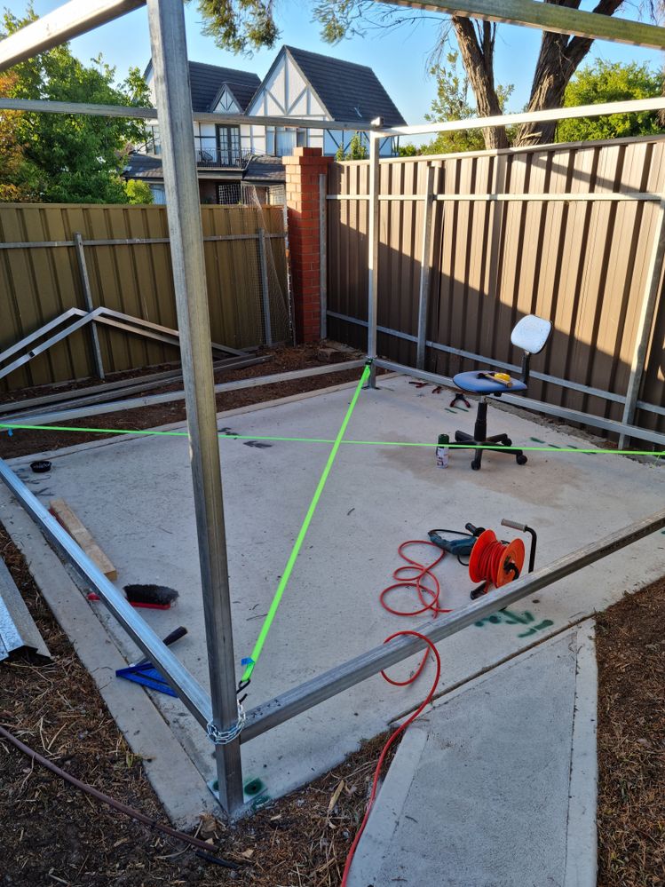

Thank you Mitchell, is it best to have the ratchets near the bottom where the poles are or half way up?
Hi @Martinb
If you have an extra set of ratchets place one set near the bottom and one set near the top. Your goal is to simulate the effect of the poles being screwed together. However, before you begin using the ratchet, I suggest double-checking that the poles are in the correct order and not switched around. In theory, the steel frame should be very square unless an error was made during the cutting process.
Hi EricL
I have both ratchets positioned about 30cm up from the slab and are both within about 20mm of each other. I checked to top cross poles and they are all 90 degrees with the down poles. My trouble is I have no one to help me move it over so I can drill the holes and my wife can't do it so I might have to drag it over bit by bit and hope it does not go out of square.
Great work @Martinb. Since you've now marked the holes, even if the frame goes out of square when moved over and back again, you should have the holes as a reference to square it back up.
