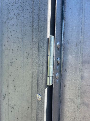

Hello Everyone!, I have a steel garden shed, 6m X 3m. Today, the left opening door (when looking front on) was caught in strong wind and the door was almost ripped off its hinges of which there are 3 in total with each secured by 6 rivets - 3 into the door frame and 3 into the shed frame. I have an idea or 2 how to fix, however, I thought I'd see if the Workshop Universe could make any recommendations that I have not thought of. See 3 pictures below. Regards, Chris

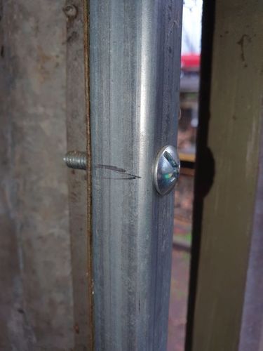

G’day Mike T, thanks for the feedback and you’re welcome. People like me who are jacks and Jill’s of all trades but masters of none are very fortunate to have access to people like you but we can’t expect you to be mind readers can we!? Hence the photos. I very much appreciate the quick responses from yourself and others. To close the loop on the shed door, there was not enough room between the door and frame to use screws of any kind so I used 150mm t hinges secured on both sides with security bolts through the metal and some merbau to strengthen the whole shibang and I put a chain on the door (thanks Dave). All the best mate, Chris

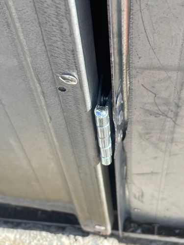

Hi Chris, I just stumbled upon this post, how did you end up fixing the hinge? I am facing the same issue after having already replaced the hinge with new rivets they failed and the doors fell off again really quickly. I bought stronger hinges and bigger rivets but they aren’t big enough and even the ones I used were too thick it makes the door not hang flush. I doubt my new fix will last long. 😂 so I’m keen to hear if your ideas worked!

To add a possible solution to the problem, I would suggest moving the hinges up or down by around 100-150mm so they are no longer near the old holes. It is likely you are having issues because the metal where the old holes are is quite deformed. Moving the hinges to fresh metal will give them a much better surface to attach to.

Thanks for your suggestions, some of the holes were new on the other hinge but I couldn’t move the second one because the drill bits all snapped no matter how gentle I was (unfortunately they were brand new too) 😩

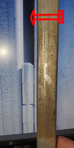

I had some long-winded suggestions - but thinking about this over a glass of wine (or two) I believe I would go to Bunnings and buy a length of 20mm gal square and cut to length to the height of your shed.
Drill out all those rivets seen on the right.
Insert the tube and bolt into place - something like this...
Maybe top/bottom/middle positions.
This then provides a new metal canvas to screw, rivet or whatever, but in the reverse direction - into the tube.
