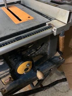

I am hoping that someone has a similar style of table saw and can provide a photo of the same part. I will provide some photos of it now. The problem is where the 2x sets of nuts should be positioned and tightened to make the saw raise and lower.
The close-up photo shows a long hex shaft with with a threaded hole through the middle (sideways). The spindle bolt which is turned by winding the (new) handle, goes through the threaded hole in the hex shaft. There are two pairs of nuts on the spindle bolt, which were locked up tight. I'm pretty sure one pair was on each side of the hex shaft.
I just can't work out where to fix each pair to make it work. I thought there is likely to be other saws out there that work in a similar fashion, and a phot of the setup might help me work it out.
