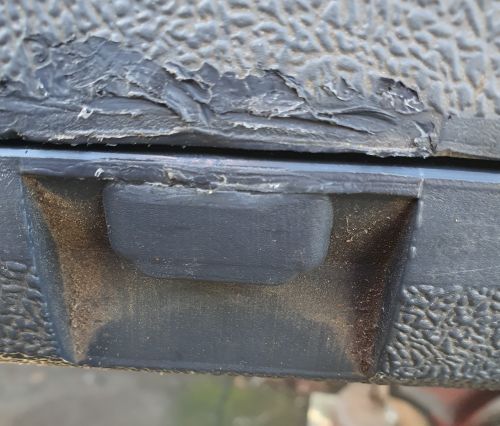

Just now - 204 sockets ended on the floor.
Plastic blow-molded case latch fatigued off.
Poor design.
Tried to plastic weld it back but failed miserably.
It's tough plastic - I believe it can be pop riveted. Anything in Bunning's armory might suit/fit?
Cheers.

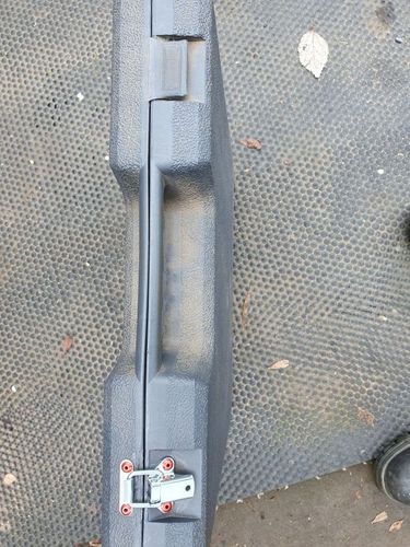

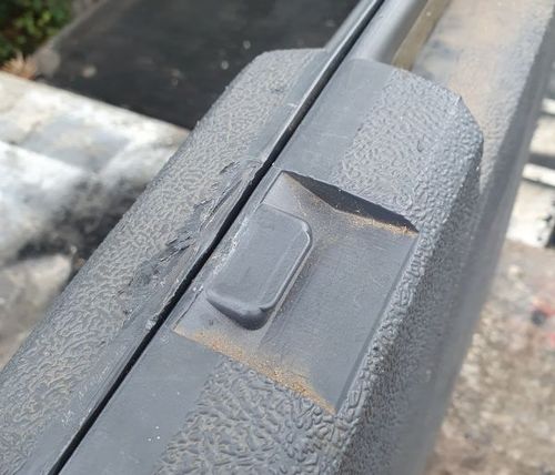

How it should look
The other side...

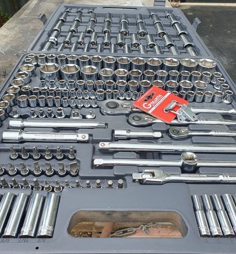

I bought a latch today - as rain is predicted for the weekend. The Goliath selection was rather diminished - only your illustrated latch was available @EricL

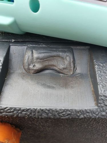

Here's the problem again...
Best fit as I could determine was with the main body on the lower side - but that plastic ridge was interfering with the fit.

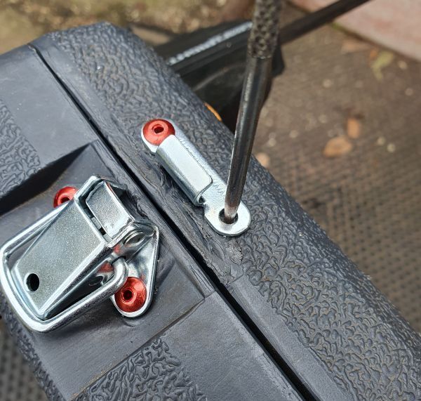

So with a little 300 watt hot-air blower I was able to heat the plastic and push that ridge down...
Next I positioned the latch - but I found with drilling up front - the drill tip tended to skip and slide, despite being just plastic.
So I punched holes with a very sharp scribe, then drilled....and pop-riveted.
Works 100% better than the original.
