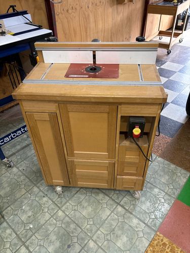

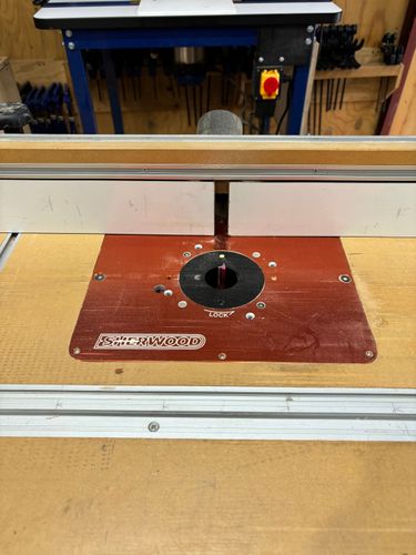

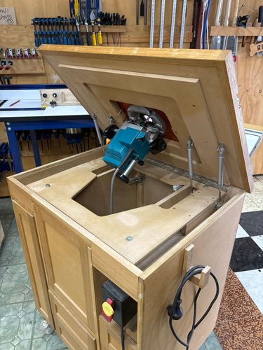

i have a Makita plunge router mounted to a home made router table with a lift up table top, I still have lower the plunge unit to get to the collet to remove the router bit.

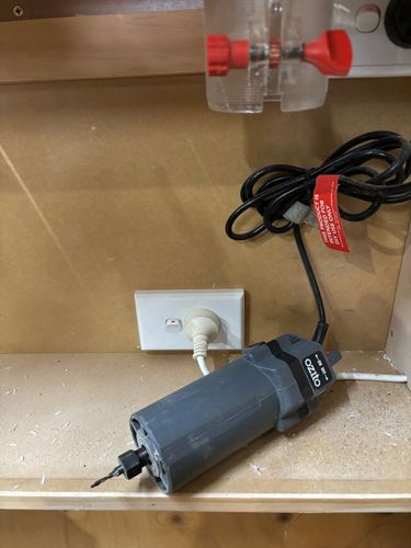

i also have an Ozito trimmer mounted to a table, this trimmer allows removal on the body unit to allow changing the router bits.
ozito trimmer
 Makita plunge router and table

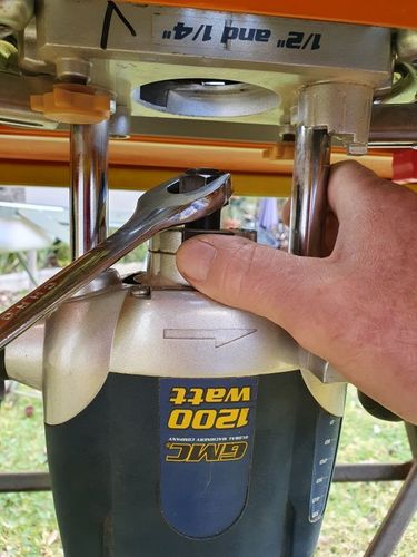

This is Triton router table with a 'generic' router that can drop 50mm.
There is plenty of room for a spanner-ed hand plus a hand to lock the spindle.
