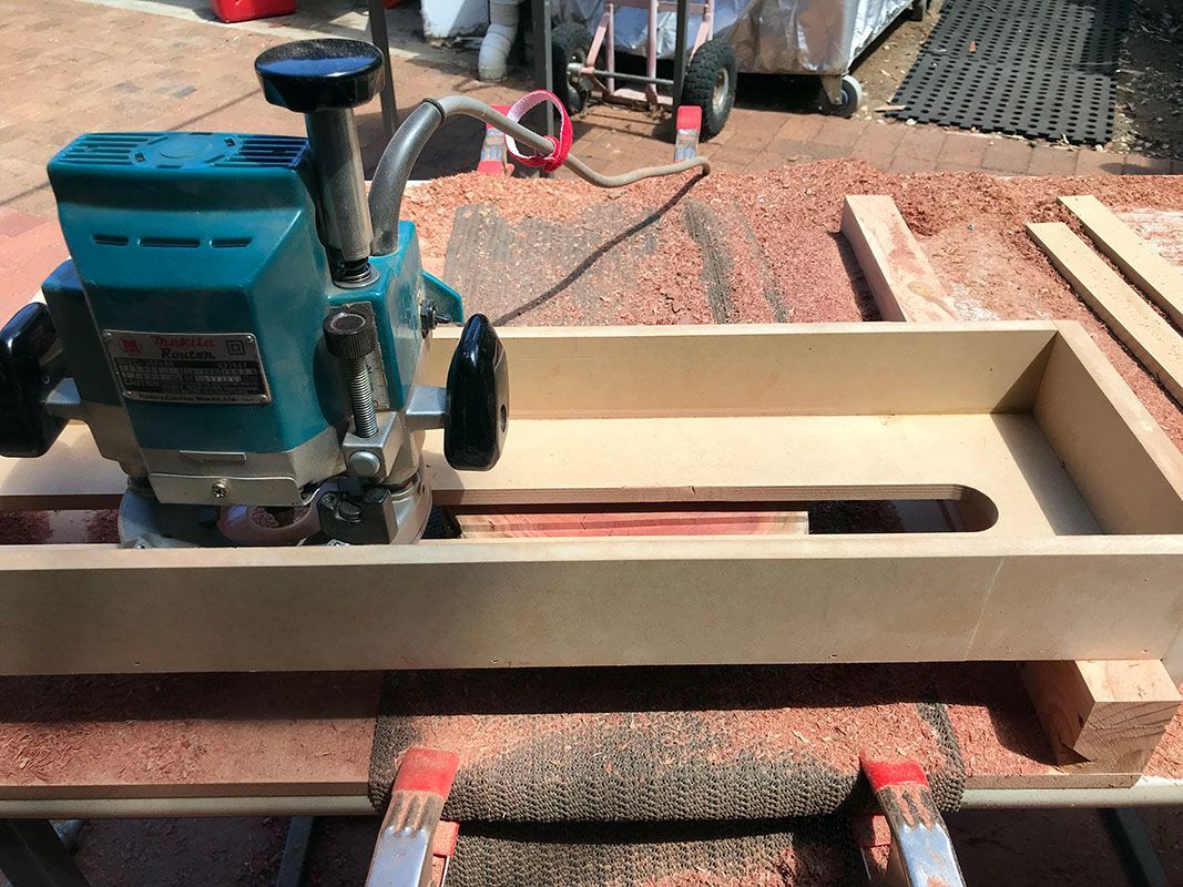

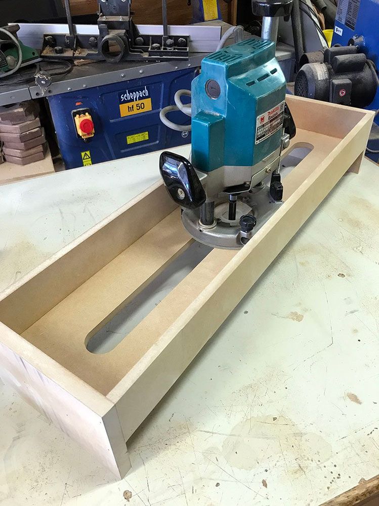

Using some 18mm MDF I made "Sled" where my router would slide back and forth and the sled itself slide along rails to route the surface of the log rounds.

Here you can see that I am taking off about 6mm off the surface of the log with each pass. There specific "Bottom Clearing" bits for this purpose but I didn't have one so I used a 3/8" Slot Cutting bit instead, this made the task a little tougher by not being able to take off as much material with each pass.

Here you can see the Router Sled and the Base with Side Rails that the sled could slide along. And the mess after levelling 14 of the log rounds.

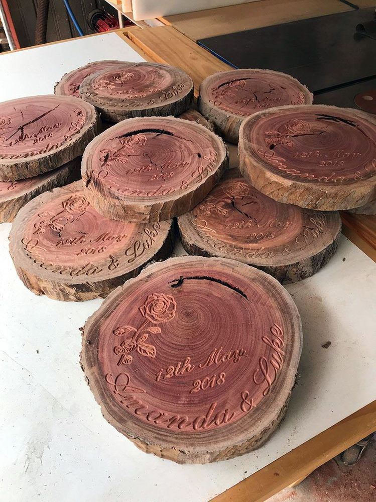

And the finished product, once they were levelled (albeit at varying thicknesses still) I used my CNC machine to engrave/carve the Bride & Groom names along with the date of the occasion and also a Rose.
An unbelievable amount of work involved for what you could possibly charge someone for them, but all the same they turned out great and more importantly a ver happy couple.

I have the same issue.  How did you stop the round from moving around while you did the first side.  I hope this makes sense.
Brad
Trusted Contributor
Re: Log Rounds as Wedding Table decorations.
Looks like an anti-slip mat to stop it moving.
I would go with dog clamps and bench dogs.
