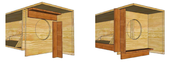

This is the unit in question..The dark angle brackets are only there for support during construction.. Screenshot_1.png

I think looking at your drawings the only option would be a Mutli-tool, different width blades are available and it would chew through MDF like butter. Not really designed to travel but a series of individual cuts will conquer the task quickly.

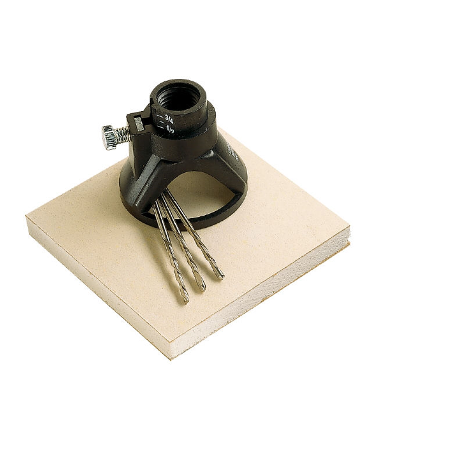

https://www.bunnings.com.au/dremel-multipurpose-cutting-kit_p6373718
Should fit in with room to spare, from memory it is painfuly slow though.
