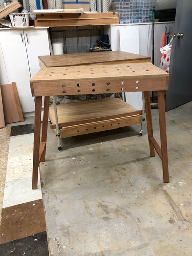

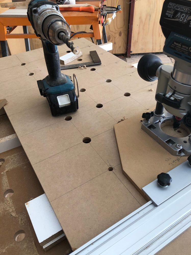

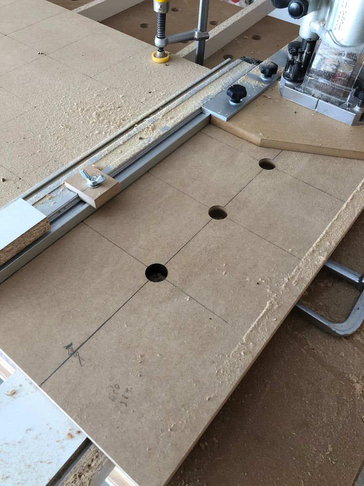

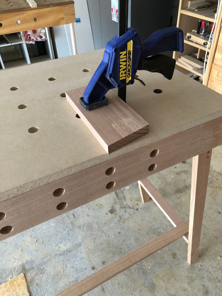

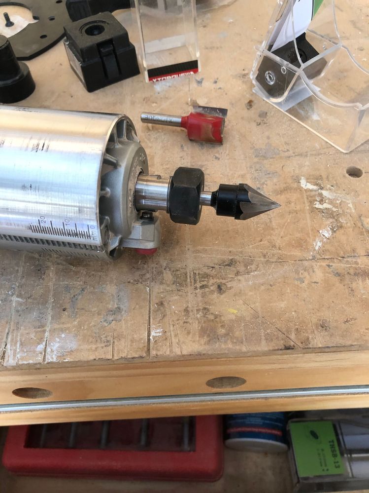

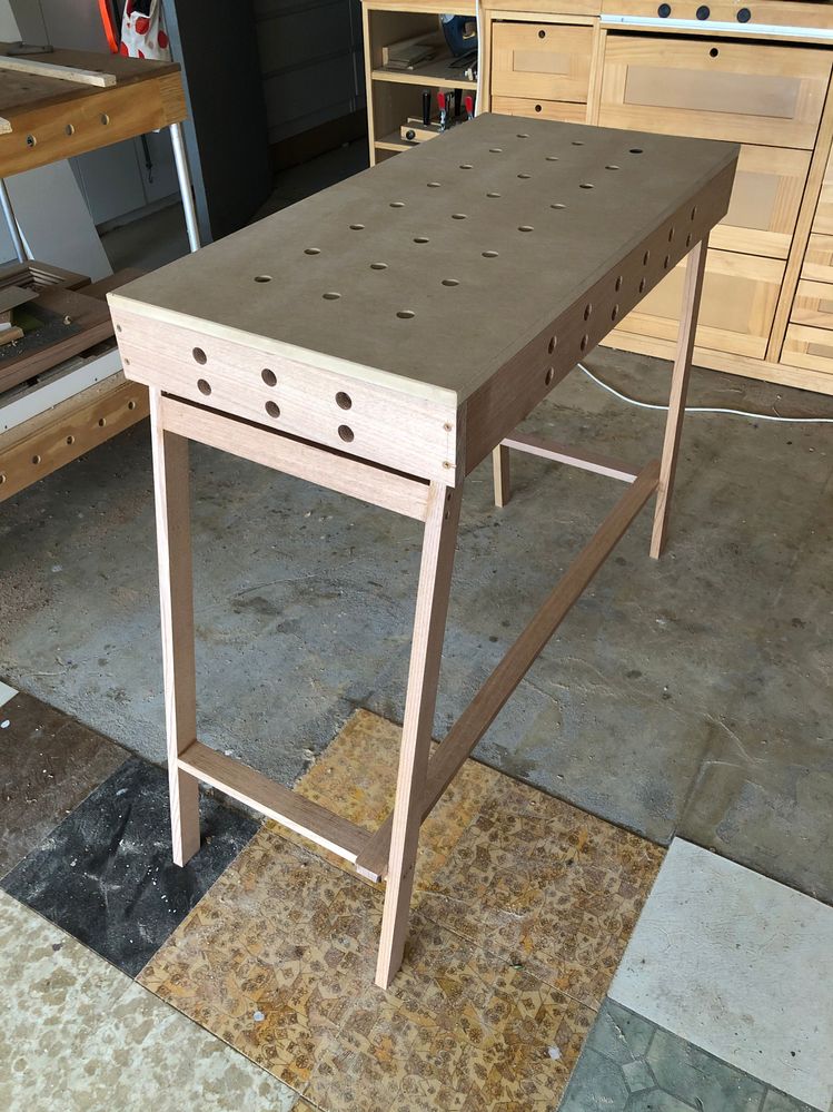

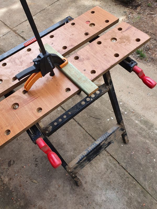

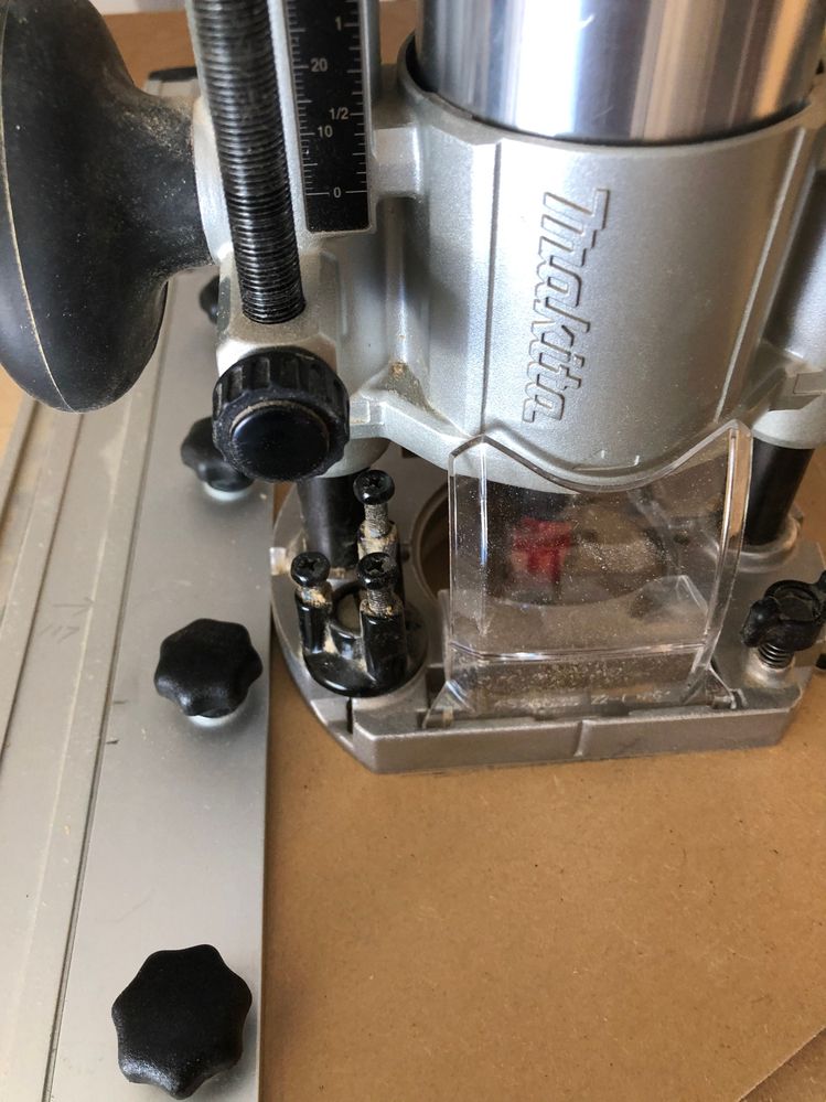

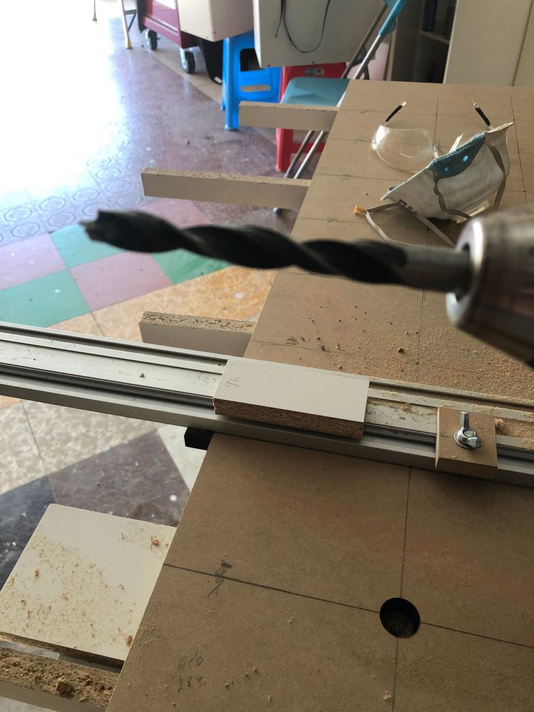

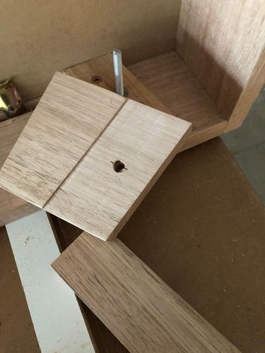

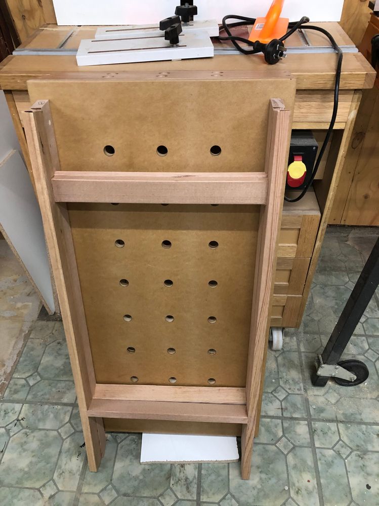

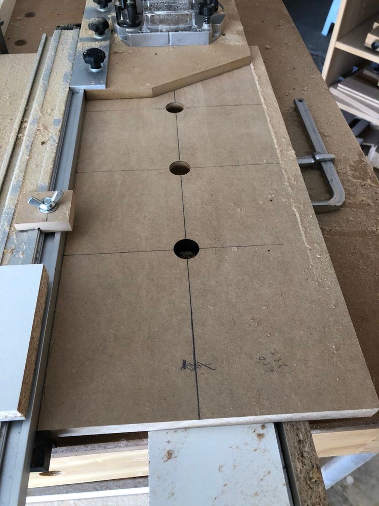

I have just completed making and installing shelves and duct cover for a range hood cupboard for my nephews new place, I new he had no work benches to work on, so I decided to to make a small portable work bench, made out of mdf top and hardwood (Tas oak) all materials are from Bunnings. The finish has been waxed,(I hate painting) I made it so I can take it apart to fit in the car. It was very useful on site. I routered 20mm equally spaced to allow for clamping the timber to be routered.IMG_7536.JPGIMG_7537.JPGIMG_7538.JPGIMG_7539.JPGIMG_7540.JPGIMG_7541.JPGIMG_7542.JPGIMG_7543.JPGIMG_7544.JPGCWGZ5056.JPGHXXV7732.JPGIMG_7535.JPGIMG_7536.JPGIMG_7541.JPGIMG_7544.JPGIMG_7567.JPGWVKP0975.JPGWZIH1072.JPG

Great idea.

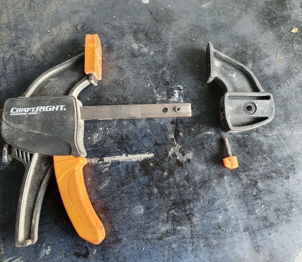

I had to look at my cheap hand vices to understand what you've done. So like these, the Irwin Quick Grip end can be disassembled and reassembled?
JoeAzza
Experienced Contributor
Re: Portable small work table, 900mm long x 450mm wide
Yes they can, if not, you can remove the roll pin on the adjusting lever end, then you can pass it through the hole and re fit the clamping part.

Fascinating setup and project @JoeAzza. I really like how you've incorporated the Irwin Quick-grips and would love to do something similar myself. Do those legs fold up for storage? If so, that would be amazing!
Many thanks for sharing.

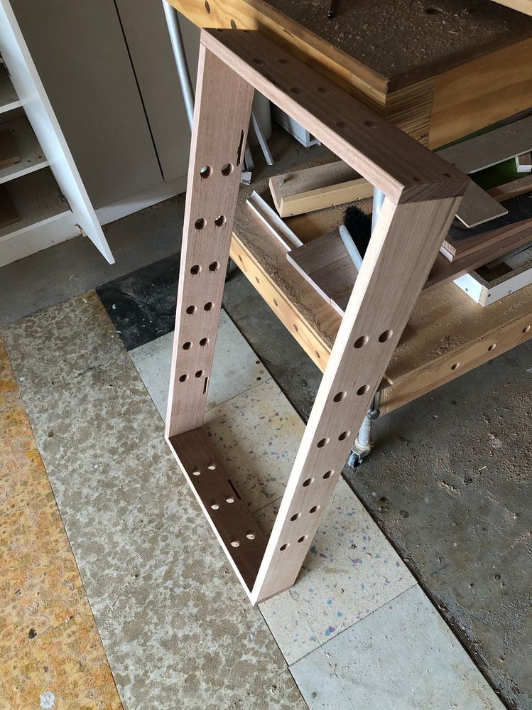

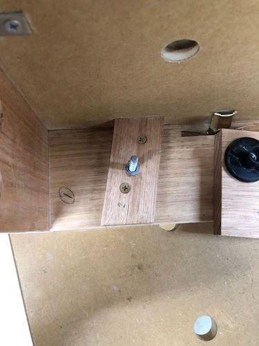

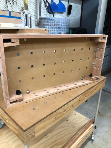

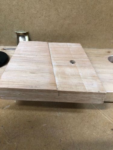

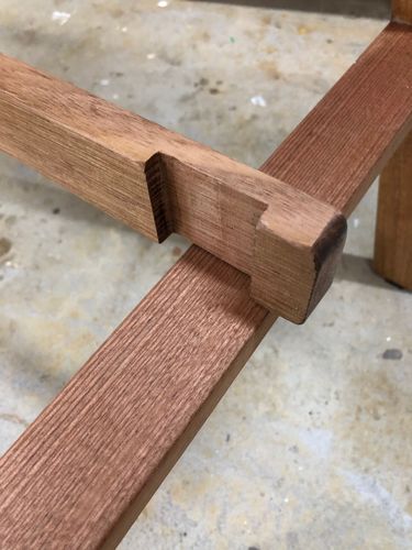

Unfortunately the legs aren't foldable, I couldn't find anything suitable from Bunnings, so I just had to improvise and come up with this idea, I needed to have it finished and ready to use for the weekend, maybe I might have a look at making foldable legs for the table, I'll post it if I do go ahead.

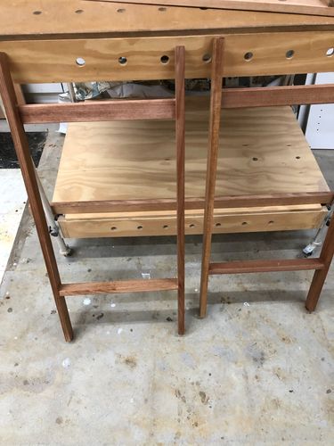

In the mean time here are some photo's of how I did my table legs.  Please excuse the quality of the photo's, I need to get used to getting them uploaded to this site.
 IMG_7565.JPGIMG_7607.JPGIMG_7610.JPGIMG_7611.JPGIMG_7612.JPGIMG_7613.JPGIMG_7614.JPGIMG_7615.JPGIMG_7616.JPGIMG_7617.JPGIMG_7618.JPGIMG_7620.JPGIMG_7621.JPGIMG_7622.JPG

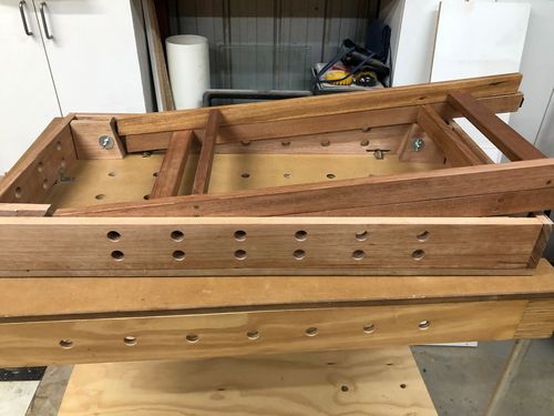

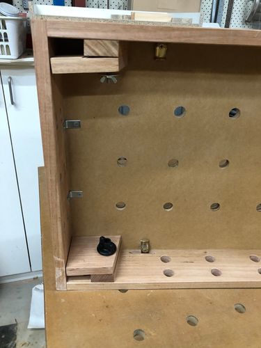

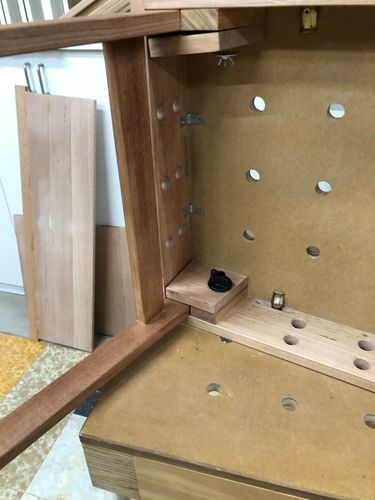

Thank you for the inspiration, re folding legs, I decided to modify my portable small work table, I have altered the legs to be foldable, pleases see photo's below. I need to see if I can get some stays for the legs to stay opened, in the meantime I just fitted a piece of timber to hold the legs apart.

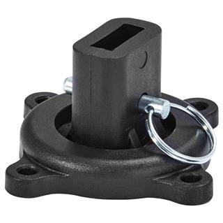

I must admit it is a well designed bench. I have done somthing similar myself but used the Irwin Quick Grip Hold down jigs. They can be ordered in by from the. special orders desk.
There are a couple of other adapters as well and my favourite is an extention bracket that lets you join two quick grips together to clamp large jobs.
