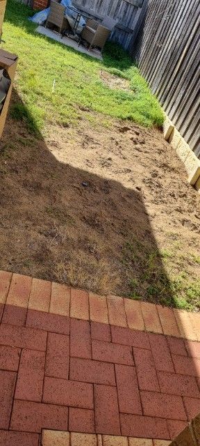

The weeded area is the proposed site for the 3m x 1.5m shed in my backyard. There is 900mm distance from the house wall.The weeded area is the proposed site for the 3m x 1.5m shed in my backyard. There is 900mm distance from the house wall.Hi Eric, just had another question if that's okay.
The person who is installing my shed (who is a Bunnings shed installer) has said that I don't need to bother with all of that fuss with things like the Decko blocks, frame etc. He said that all I need for the shed floor are concrete pavers with pavelock which will 100% keep any water, weeds, etc, out.
Is this correct?
Also, if I have to take the option of using concrete pavers for the shed floor, can I use them without pavelock and then just use a sealant such as Sikaflex 11FC which I saw recommended on another post here? Or would you recommend something else?
In the latter situation which would be the best type and size and thickness of concrete pavers for a 3m x 1.5m shed, to give it the best chance of being as watertight as possible?

Thanks for the additional information and the picture of the proposed site. Pavers being a porous material often hold moisture inside of them. When the temperature is cold enough it causes condensation on the surface of the paver. To add an extra layer of protection against moisture, I recommend putting in builder's plastic on the ground and then put the pavers on top of the plastic. The plastic will serve as a moisture barrier to prevent ground moisture from passing through the gaps of the pavers.
The Sikaflex 11FC will provide an adequate seal between the pavers and keep them together. The adhesive is stronger than Pavelock and it will last much longer even with vigorous cleaning of the shed floor.
It all depends on your budget and how much protection you want to give your items in the shed. I still believe that the elevated frame would give you better protection. One extra plus in having an elevated frame is that even if there is a large deluge of rain or a severe thunderstorm, your shed floor will be high and dry.
In regards to the type of paver, I propose getting something that is at least 40mm thick so that it can carry some weight. I also recommend getting the biggest one at the most affordable price so that that there are fewer gaps. A good example would be the Custom Concrete Products 600 x 600 x 40mm Plain Paver.

I would also be concerned about water into my shed. All the sheds I have seen built at ground level end up having water run through them.  Both bconcrete flooring and paving ones. I like @EricL's idea as being the most dry long term.
If money was an issue you could still have a raised floor using pavers or bricks to rest the timber on. I like the idea of a raised floor for air circulation and ease that water can run away. With pavers even with the plastic barrier underneath water can still come in from the top. What type of shed are you going to have? Is it a premade that is put together?
Looking at your picture one question is where will the water go when it rains, wether you use pavers or raised its always an idea to follow the path of last resistance with water.

Yes its definitely 1.52m depth x 3m wide.
No, its not a pathway lol.
No I don't have access to a concrete mixer but thank you for your suggestion though, many people have suggested a concrete slab to me as well! Unfortunately its not an option for me.
