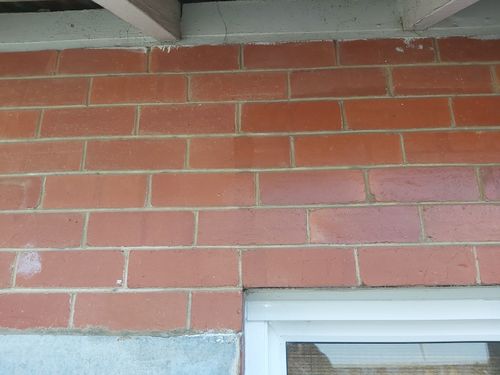

To answer the question about how the waterproofer looks, I used the product @MitchellMc recommended too... rain poured down from the roof and seeped through the single brick there. Here is a pic of the effect. The coating stops at the window edge... a slight sheen. The eaves in the pic end just to the right, so rain hits the wall there (& also goes into the stoney drain).

Thanks @TedBear that looks discrete. I think I'll get some and cover the brick retaining wall and some of the side walls. They all get a lot of splashing of rain off the boulders.
