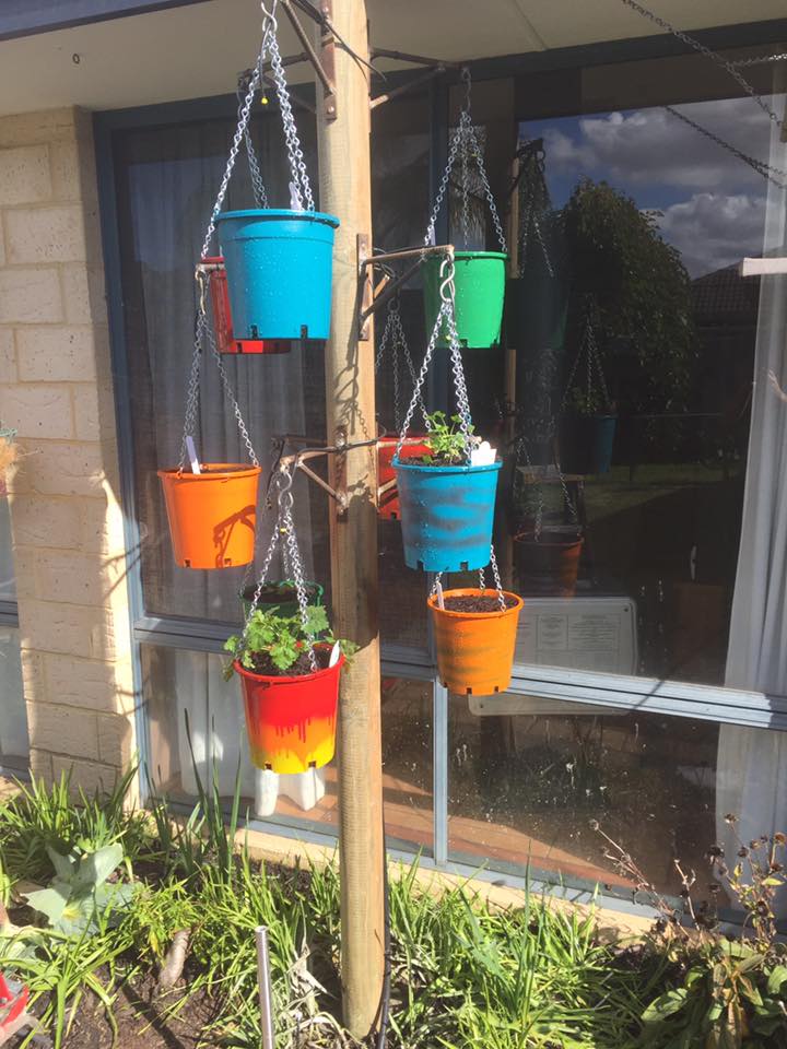

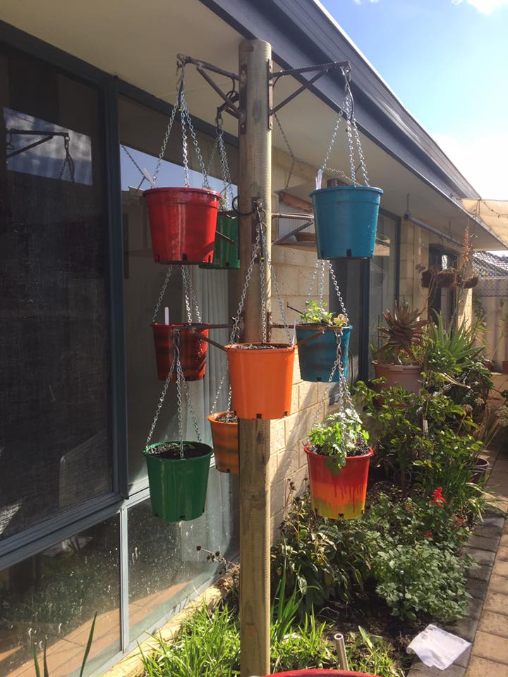

When we were in Brisbane over Xmas, mum got a weather station which she has been wanting for a while.  Solution, one copper log.  However it was missing something.  Deb and I went out and got some pots, hangers and plants and created a masterpiece.  Back in Perth, Deb was keen on doing the same thing at our place as space is getting short.  Solution, leftover bits and pieces this time as mum's creation cost a fortune.  See below for the complete recycled vertical hanging garden.
Ok, I bought the coppers logs, but everything else is recycled.  Post quickset into ground. Rio and flat bar left over from a job welded to make hangers, jack chain and 5mm rod bent for the pots.  Pots are just ordinary black pots.  Paint (suitable for plastic) was applied to make them look different.  And of course heaps of herbs for upcoming BBQ delights (and beers of course).  And @Andy_Mann still not a gnome in sight.  Maybe I should get some to mow the lawn...... (giggle giggle)
