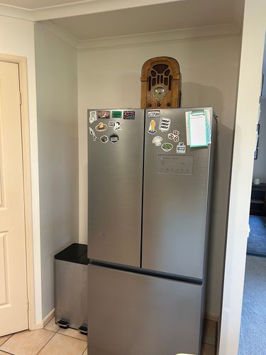

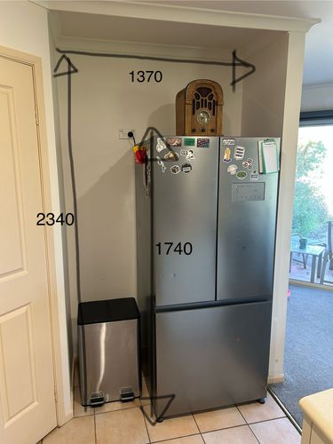

Hi all!
I’m hoping to make some shelves, possibly a cupboard, around and on top of the fridge in the kitchen. We find our fridge top just ends up a dumping ground for junk, so I’d love to have an actual place for said junk.
In the open space where our bin currently is and where we would like a bin to remain, the current bin height is 600.
The area is 600 deep (didn’t get a chance to right it on the pic sorry)
Can anyone suggest any design ideas, taking into account we have a very low budget and I would like to DIY myself :smile:
Any suggestions/mockups welcome!!!

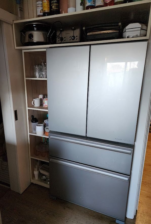

Same here. I went with undressed pine (around $12 L/M) 295mm wide and 5.4 m lengths. I biscuit joined the planks to get close to 600mm depth.
The vertical shelves are on wheels - you can move it out to gain electrical access for the fridge.
White washed.
Then polyurethane.
I'm thinking you could move the bin elsewhere for more shelves?
Just a Saturday morning coffee thought.
Cheers.
