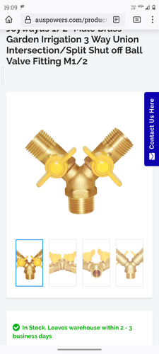

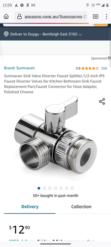

I understand that I couldn't find a dual tap adaptor connects directly to my faucet so maybe there are some attacments to dual one of the exits to hook up both. I need your opinion here are, the photo from Amazon with a diverter stop is what I use for my benchtops dishwasher. I looked for options but mostly there are for taps, wall, or garden, cannot be screwed in to my tap as it has shorter female and those I shared do not fit in.

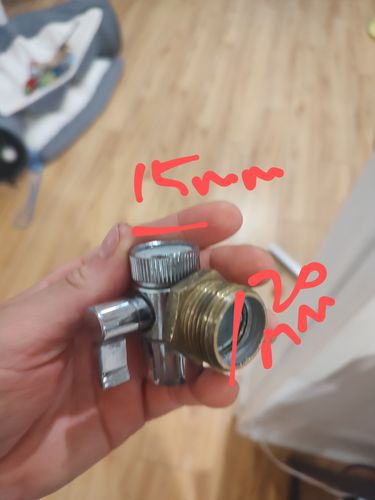

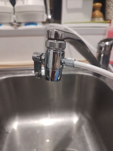

Hey thanks for the interest. Here are some photos
Faucet is typical 15mm
As well as the gadget for water filter
And valve I used to screw in to faucet and used side part 20mm for dishwasher
I would like to use both now in a dual system and don't need the tap working normally in that situation as I will use filtered water for everything in the kitchen. Thanks heaps

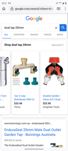

Hey Eric, thanks for the answer. The problem is with those dual brass is, the are not compatible for kitchen faucets and I couldn't find any aerotor adaptor for connecting faucet to those dual systems.
They are all seems to be eligible for garden taps or washing machine taps. Any suggestion?.
