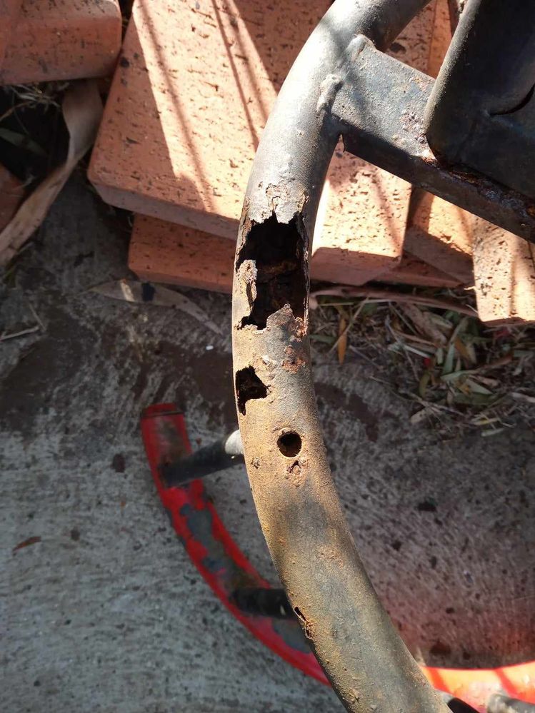

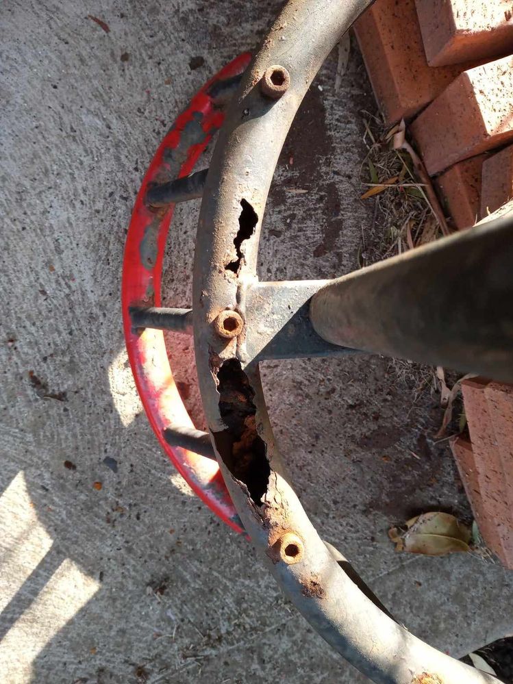

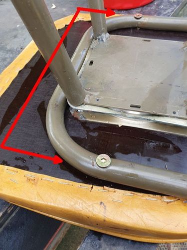

This is my dearly departed grandmother's kitchen stool. She passed away 17 years ago and since then  my mother has had the stool outside. Mum is down sizing so she gave it to me. I want to restore it but I have no idea how to do that. Can anybody help with some ideas please ?Nan's chairNan's chairrust holesrust holesmore rust  holesmore rust holes

The tubular steel is in the advanced stages of disintegration and is structurally compromised. Even if you were able to stop its progression by applying rust converter, there doesn't appear to be enough steel left in the rear back support for the chair to function safely. You could tidy the chair up, sand back any rusty sections, and apply a fresh coat of paint. Though, I'd recommend it's only used as an ornamental piece from now on, as it's really too far gone to save.
The only option I can see for a full restoration would be to cut off the top tubular seat ring and replace it with a new one. However, this would require you to be able to roll the tube into a circle and weld it back into position.

I agree with @MitchellMc  on this unfortunately, due to the rusted out section that the back is attached to.
If you restore it as an ornamental piece I suggest filling the large gaps with a builder's bog, which can be sanded smooth to match up with the surrounding casing. After painting you won't see it.  But use the rust converter first to prevent ongoing decay.
Otherwise I'd suggest taking it to a welder (or try a Men's Shed, if there's one around) to see what they'd charge to replace the main seat supporting ring, including drilling the holes for back supports. That would give you the best outcome.

A Men's Shed (a good suggestion) or someone with some metalwork experience could save the seat - and make it practical, but I would make it square with 50mm X 20mm rectangular steel (preferably not galvanised) with mitred joins to hide the internal spaces. Re-weld the legs and back into place. Thick plywood, foam, vinyl and staples would make the new seat.

I really like @TedBear's idea and also @Noyade's about a local mens shed to replace those rusted tubular rings if possible. It may be problomatic as tubes are generally thin and therefore harder to reweld. No harm in asking tho.
Going through the pictures again I dont think the rings would be able to be replaced 😕 But rust converter and removal of the rust followed by timber bog into the tube (which hardens harder then timber) and if you added more cross structual support under the seat to the ring would make it usable without changing the overall look. Id still go to a local mens shed as they may have a welding person and are sure to have ideas also.

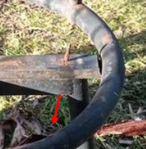

I think if you punched out those 4 heavily rusted screws, the top part of the chair frame would come away completely - and we could then see the condition of the leg framework metal cross section.

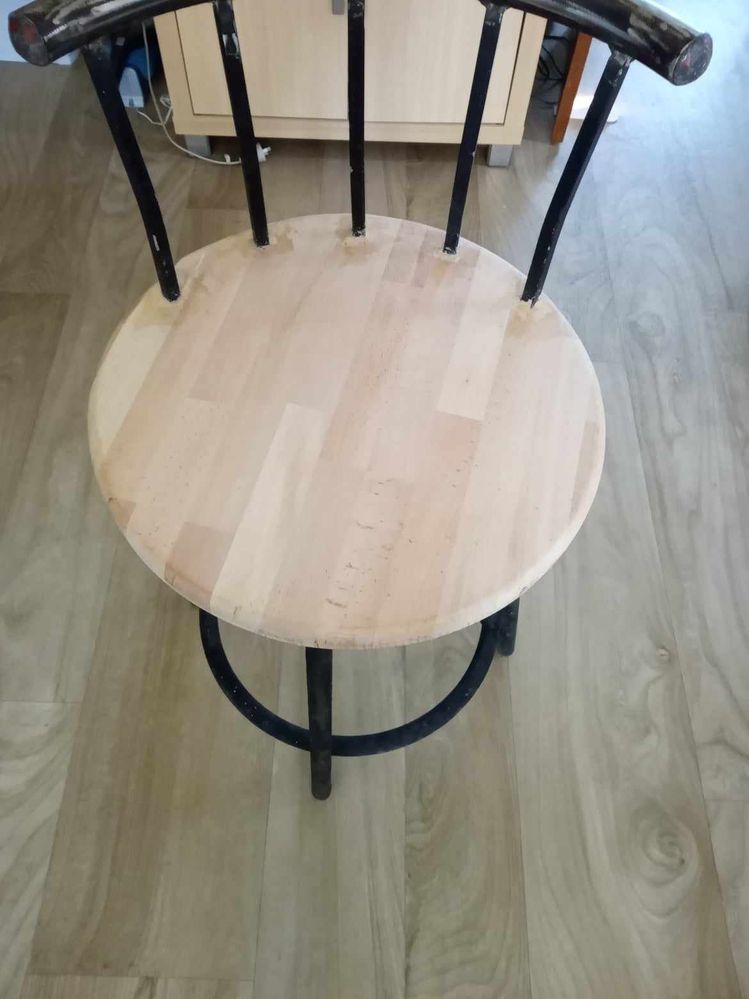

Hi. I took the chair to the Men's Shed. They are going to restore it for me.  I had a thought last night of throwing it to the tip & buy  new one. I woke up this morning with a change of mind. It's sentimental to me. When it's finished, I will post a photo for everyone to see. Thank you all for your suggestions. Take care xx

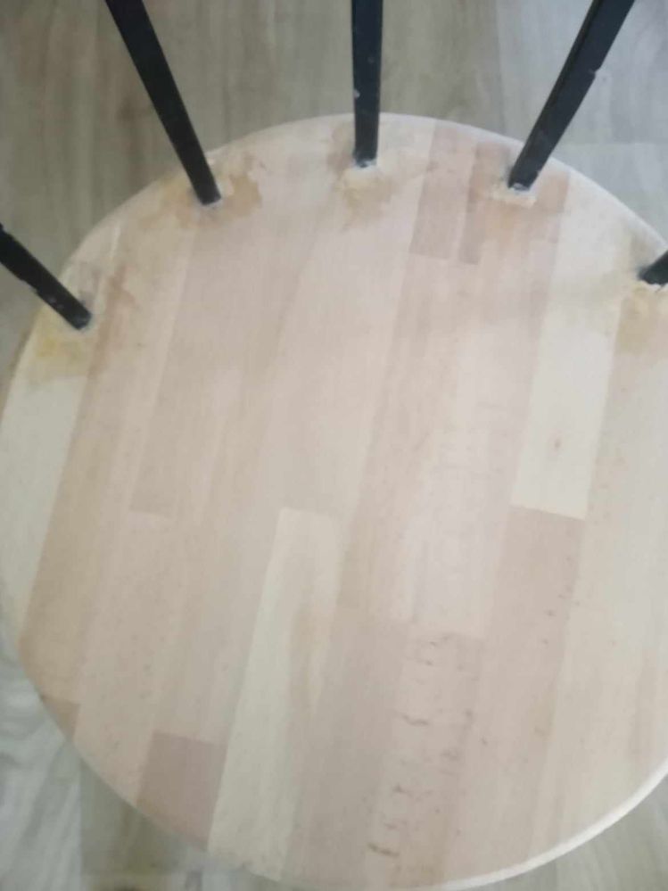

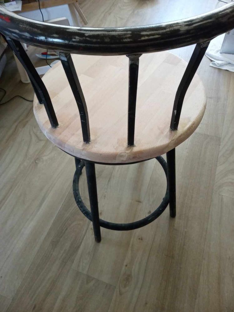

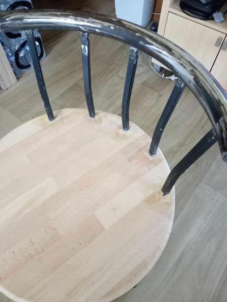

Hi everyone. Just an update on the restoration on the kitchen stool. I contacted The Men's Shed. They have done an amazing job. When I seen the finished result, I had tears. I do have to paint it. I will post photos when it's done... Here are a few photos of the restore so far. 379672176_838834764635470_3721936021295926551_n.jpg380050953_1454880911911271_1198993975808033965_n.jpg380107829_1048733526125116_8157900579709005555_n.jpg380197413_1031028911644957_4185563616354458379_n.jpg380465799_874510654060608_3855393962912314733_n.jpg
