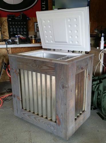

Something like this would be cool. I would have thought you could do anything to the sides and front, just not the back.

Do not cover up the controls or vent if you want to  cover them with a little door with a frame around it with a mesh of sim sort over the vent so that it can vent heat. Another suggestion is to make the outer cover about 5 mm gap between cover and freezer held steady with son spacers the San size as the gap

I think I would use some blocks on the sides so you can avoid having to deal with the hinges and you can slip the power cord underneath as well.
Spotlight have caning mesh which you could use on the vents, there are plenty of options you could use, I tend to overbuild so I would put some slats in to make louvers.
I would tend to go epoxy glue over wood glue when sticking to metal, double sided tape could work but the reformed welder in me has doubts it would be strong enough.

Hi @LJ1809 - looks like a fun project. You could use epoxy glue as @Brad suggested. The other possibility is something like liquid nails (if you have a caulking gun). Either way, I’d be standing the shine off the exterior so the glue has something to key to, cheers Deb
