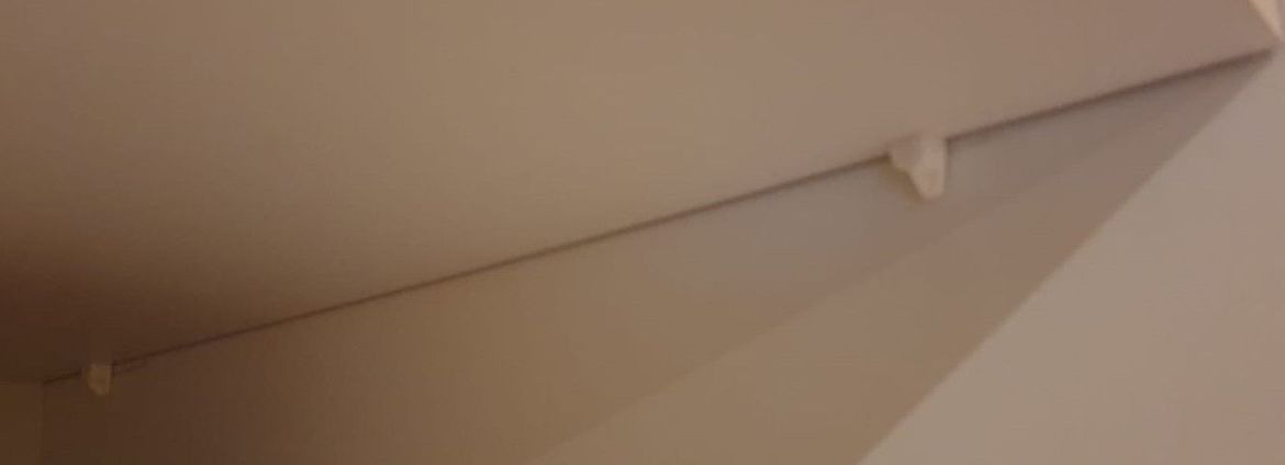

The shelf in one of the kitchen cupboards seems to be sagging in the middle. The shelf is held by two screws on either side as shown in either photo. Any suggestions on how to reinforce the shelf or support it better
If you have a thick back on the cupboard you could add some more shelf pins along the back, that is unlikely though if they were flat packs.
Simple temporary fix is to turn the shelf over, it is unlikely to be fixed in and should just be sitting on the pins.
Putting in a bracing piece along the length of the shelf, back is least in the way and center gives the best support.

I'd agree with the methods he's described. Flip the shelf for a simple fix and wait until it sags back into the correct horizontal plane. Screw a piece of 42 x 19mm 1.2m Standard Grade Dressed Pine into the rear panel if it has a thickness to it or alternatively screw it directly into the shelf. As Brad mentioned you really need central support to stop the front sagging as well.

Thankyou Mitchell. Shelf has been fixed as per the instructions. It seems to be holding well
