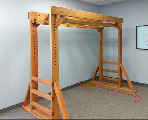

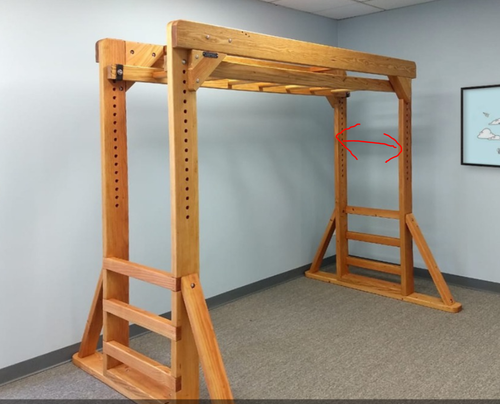

. When you say widening the end pieces, are you referring to pic 1 or 2 or something else? sorry I am very new to this..
1)
2)

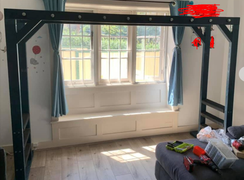

Actually, I got this idea from one of my friends who have it indoors.. like this.

Hi @JohnC5 , yes I was thinking of something exactly like the extensions in those first 2 pictures. It would make the unit safer given that it can't be anchored in your circumstances. It will be interesting to see your project when you make it and the benefits that you are wanting from it.
Hello @JohnC5
In reference to the photo you posted, yes that is exactly what you need to do. You need to extend both the width of the assembly and the footing to make it secure.
