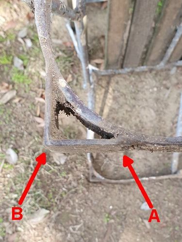

Here's a metal equivalent. It was an old metal chair frame left on a nature-strip which I took home and replaced the wood slats.
With a beer in hand I tested it out - and leant back.
In the blink of an eye I was sprawled on the concrete, flat on my back drenched in beer.
The solution, apart from hanging onto your beer glass tighter, was to weld a piece of angle-iron onto the curved section - moving the chair's fulcrum from A to B (50mm). It's amazing what a small shift in the fulcrum will do to the centre of gravity. I'm not sure why manufacturers make curved sections on chairs like this.
