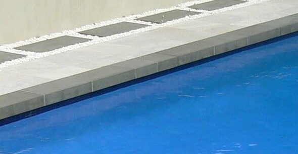

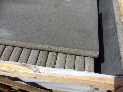

What would you chose for pool coping - a rounded edge or a square edge?

Your first image is called bullnose coping.
Your second pic is drop face coping, which is probably more popular right now, as its a modern look. It will also be more expensive.

@Joker - I think the bullnose coping looks pretty old school, like something you might find on a pool in Los Angeles in the 80s. I'd definitely go for the drop face coping.
