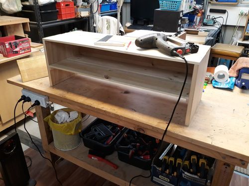

Dressed pine is expensive (everywhere) and here is a video clip turning fence palings into dressed pine boards.
Note-1: I don't go overboard just enough to make them respectable.
Note-2: The WorkZone unit was gifted to me.
That lot was for a hand tool storage cabinet.
That cost less than $10 bucks.
Yeah... so get one you will love it 😊

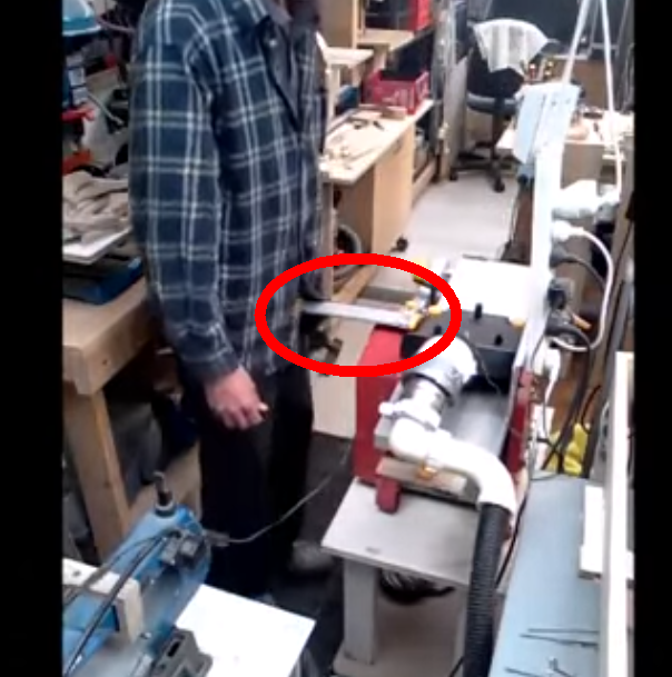

What is that piece of metal (purpose?) that seems to keep jabbing at your abdomen?
Howdy @Noyade
That's a blade guard mate!... I need to add to the safety gear a cricket Abdominal guard AKA Groin protector AKA Box 😄

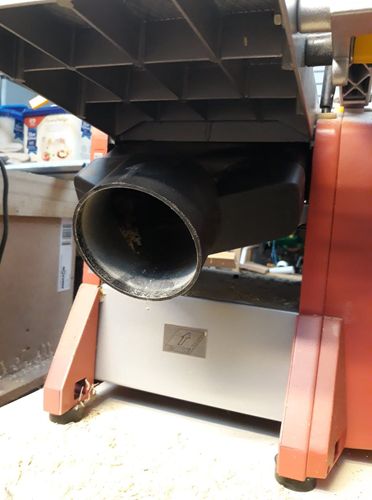

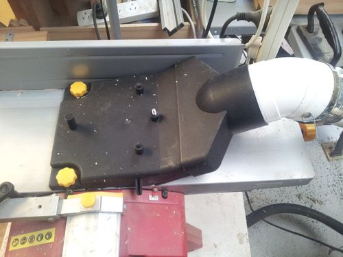

When setting up the unit for thicknesser mode the guard is pulled out all the way to clear the table for mounting the dust port.
Although a nuisance... and by design for safety reasons the guard cannot be completely removed.
To setup for planer mode the dust port in mounted inside the unit.
Extraction plumbing includes pineapple tins 😀
Had to remove the base to squeeze the vac under the table.

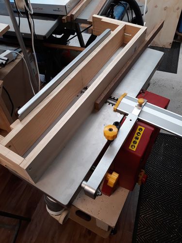

I made a fence to even blade wear when edging timber.
