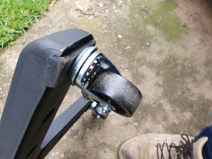

Bought a large (75cm Ironhorse brand) fan from Bunnings a few years back, very good, but very heavy and awkward to move about outside.
So I added castors to the base. Having a back injury - I'm loving it. Usually when I do something like this it's obvious cosmetically wise that it's an add-on, but with this little project - it sorta looks like they were always there (well - almost). ![]()
Castoring
Not too difficult.
Scrap 5mm X 20mm steel plate welded to the outsides of the base frame legs.
The plate was drilled and tapped to take the 8mm bolt castors from Bunnings (I forget the brand :-()
The inner part of the base frame has a plastic ballast that goes to the outter tips of the legs. This method avoided these.
Black spray paint.
Happy rolling!
