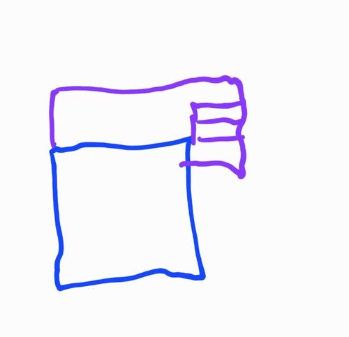

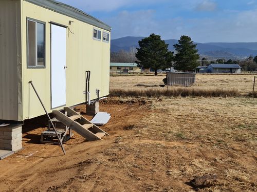

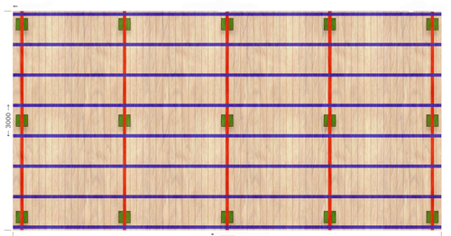

I'm hoping to embark on a decking project, but there are some challenges. I've attached some photos of the site, a diagram of posts, bearers and joists I found elsewhere and a rough drawing of the planned deck. At its front edge away from the building it will be almost at ground level. I found some good information on here but my issues are as follows:
The ground under the deck does not slope away, would it be ok to build a deck on this ground as long as the concrete footings are proud of ground level and don't allow water to gather?
I'd prefer to run bearers along the long axis and joists coming out perpendicular to the building, allowing me to run the decking lengthways across the front of the building, would this be an issue?

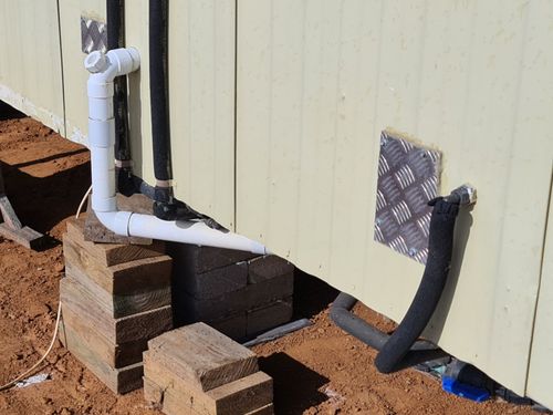

There are pipes running down the side of the building which would interfere with a one piece ledger board, how do I remedy this?
With regard to stairs to climb from the lower ground level to deck level, how are these created, mounted and attached to the deck/secured to the ground?

It's great that you've found some useful information about deck building in the community. To keep your deck safe from water accumulation underneath, I suggest installing at least two french drains running parallel and equally spaced to provide adequate drainage for the area. Should you encounter very strong rain the french drains you've installed will protect your deck from getting water trapped underneath.
There are no issues with your plan on the framing layout, however, I would recommend drawing your own plan so that you'll be very familiar with the distance of the footings. Please keep in mind that the timber framing you'll be using will determine the distance you can place your footing.
Having pipes running along the wall means that you'll have to modify your deck framing and possibly add extra footing to support this part of the deck. Extra noggins and an independent free-floating frame are some of the things you'll have to consider when going around your pipes.

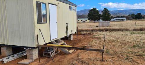

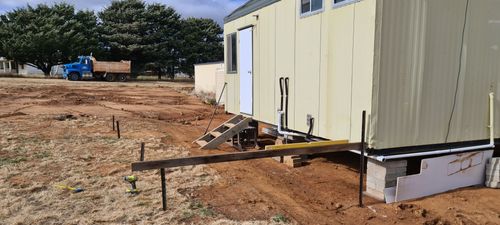

I've put some pegs in which gives me a better idea of the fall under the deck. The deck finished height is roughly the underside surface of the board in the photos. The shortest peg is 370mm so I've got plenty of room for concrete footings, stirrups and varying length posts, with 120x45mm for bearers and 90x45mm for joists, plus 19mm decking.
With the height of the deck I can probably also do some minor earthworks so that ground falls away from the deck, which will be covered anyway so the ground under the deck won't receive any direct rainfall through the deck.
With the bearer and joist sizes mentioned how far apart should the joists be at a maximum (i.e. what's the minimum number of joists I could get away with)?

It's great that you've found some 6-meter length decking boards. I suggest having a look at the Hyne Span Table, it should give you a very good idea of how far the bearers and joists should be. I also suggest having a look at this discussion - Low-level composite deck over concrete slab by @Nat2. It's a very good example of a single-level deck frame with uneven mounting to the house.

Doing a bit of earthworks is always a plus and will prevent the bottom of your deck from getting water logged.
