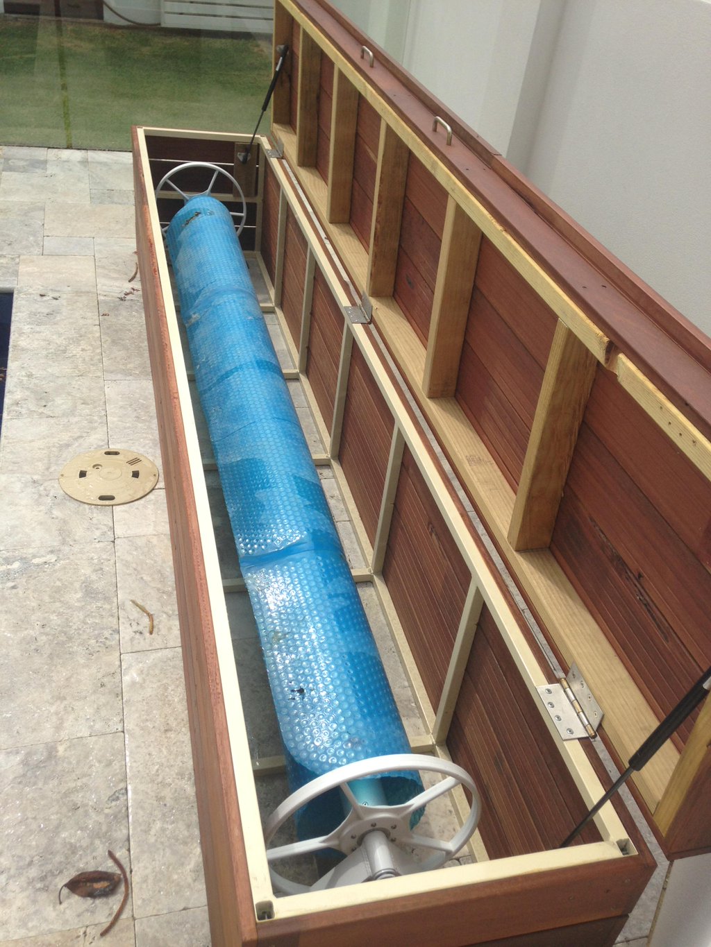

I still like this design the best, but I'm thinking I would prefer if it was sunk into the ground at the end of the pool just after the pool coping ends. My wife thinks that won't work as it will get dirty inside, fill up with water, etc. Any suggestions?
Andy_Mann
Former Community Member
Re: Hiding a pool cover roller
G'day Joker, I like your pic of the sunken enclosure, but if you're concerned about water & crud ingress, set the box section slightly above ground, & build the lid larger so that it overlaps the box, plus put some form of rubber or silicone weather strip between them.

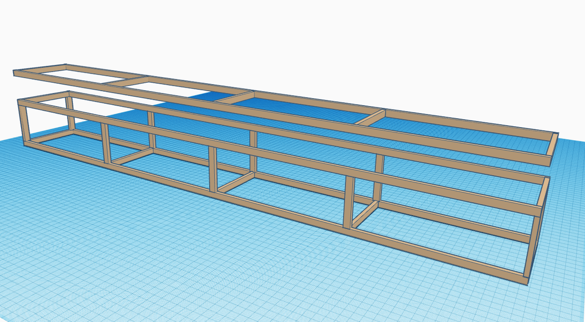

I put a couple of renderings together for you below. Hopefully, they'll depict how you could construct this project yourself from 90 x 45mm treated pine and decking.
Hey Mitchell, rendering very helpful. Just wondering your thoughts about being able to put this on wheels suitable to be left outdoors and support the weight of the roller, mat, structure and people sitting on it?

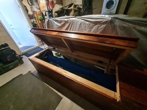

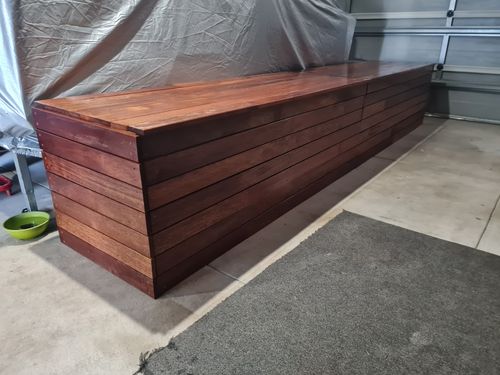

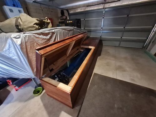

So I spent a few days in the garage building this pool blanket box and this was my 1st attempt at anything woodwork related, all in all I don't think I did too bad if a job
