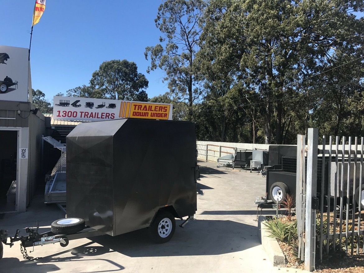

i building a smallish enclosed somthing like thisbox trailer i need to know what should i use to build it please tell me if you know.

Unless you are wanting to do a ground-up build of the trailer then I would suggest starting with a box trailer. You might like to check out second-hand options or purchase something new. We have a fantastic range of trailers you could base your build off.
You'll need to build an internal steel frame out of boxed tubing to create the enclosed area. Do you have any welding experience or know someone that could assist you? There are quite a few entree level welders to get you started. Galvanised sheet can then be pop-riveted to your frame to enclose it.
It would be a good idea to do some investigation as to whether building something like this would require an engineering certificate in your state. If so there might be requirements on the type and thickness of steel you need to use and how it affixes to the trailer.

I do know here they offer a flat top with rego and papers that you can then make your own top to suit yourself and that saves a lot of hassle sorting out the base unit and it is how I would start building.
Googling, I see where that boxed trailer illustrated above is $6,400.
https://trailersdownunder.com.au/product/7x6-heavy-duty-single-axle-fully-enclosed-van-trailer-for-sale/

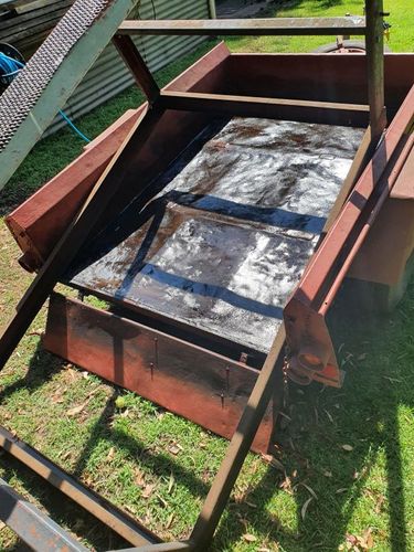

Pure thread drift, but I wanted to "box" my trailer 20 years ago. Nostalgia and sentiment, I did not want to structurally change the trailer.
So I welded up a frame that sat/slid into the trailer.
That frame then became a canvas for various gig/rigs and sheet metal to box it in.
Best part is, like Batman, I can ditch the box in minutes and speed away with a clean trailer.
