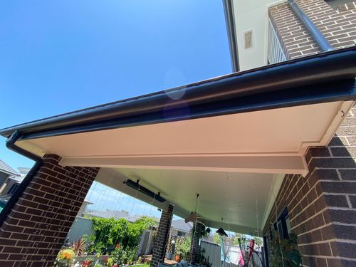

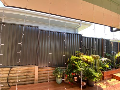

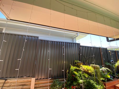

yes, you are right. I need to attach to rafters. So my question to you and the other members is easy way to find rafter location behind metal fascia.. so that my screws from front timber can go to roof rafters behind colourblind metal fascia..
I have to build very small pergola say 1m from fascia to fence.. attaching fee pictures.

@j_nilesh,
You could use a stud detector on the eave lining underneath the roof to give you a general idea of their location. The issue is determining where they finish and the length of fixings needed to go through the fascia and into them. The rafters don't always finish directly behind the fascia. Without removing the fascia it would be difficult to get an idea of what you are fixing into.

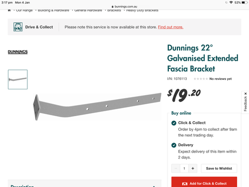

Im currently doing this. I used the brackets in the photo. Take some tiles off your roof where your trusses are, attach an additional 90x45 piece up the truss and attach this bracket with M10 bolts. If you use a drill with a 6mm bit you can drill the holes in the fascia for the bracket to then come through.
You then attach the pergola to this bracket. It seems hard but once you do the first one you’ll be fine. I had to do 12 for the length of my pergola.
This was also recommended by my council as I got a permit and they advised this way of doing it.
