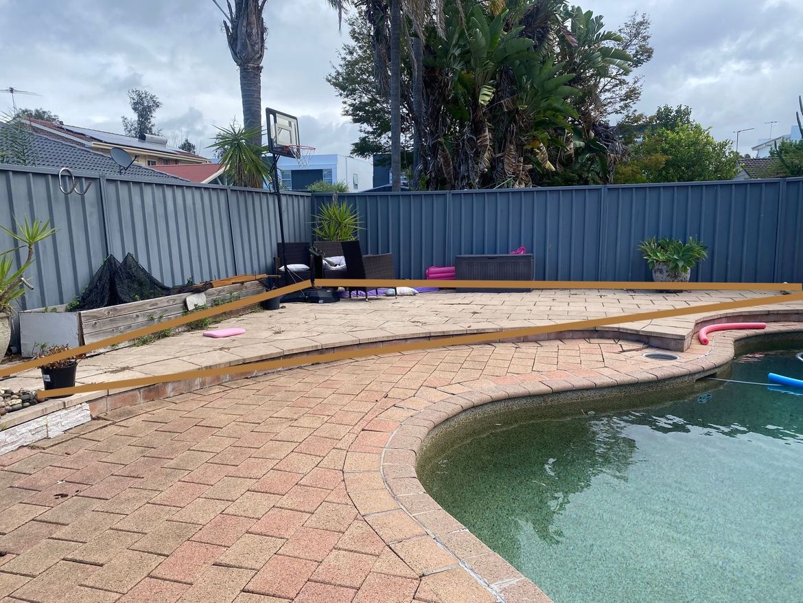

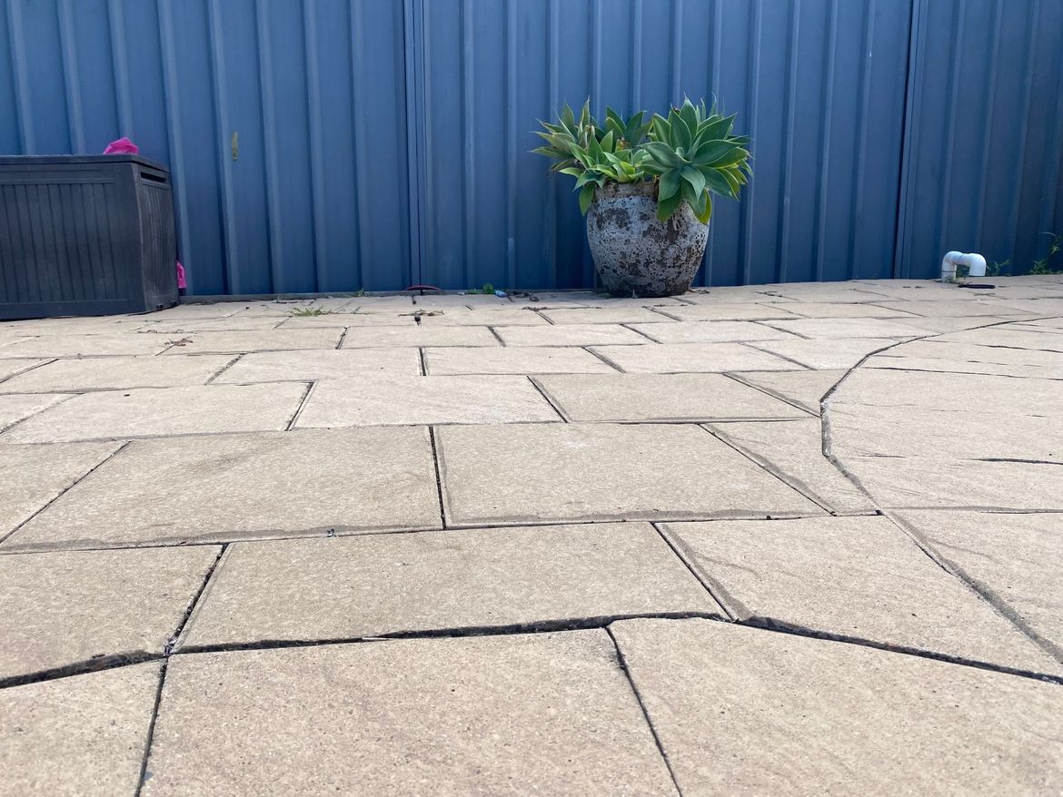

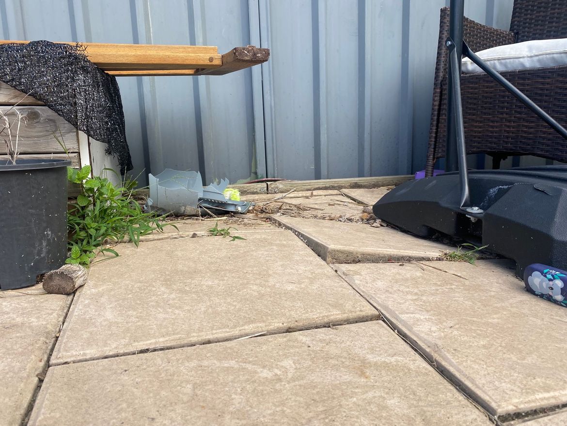

Ive attached some pictures, ideally I prefer not to go from the pavers as it will make the deck very high.
I would add my DIY ability is somewhere between beginner and intermediate
I have build gates, fences and screens previously but not much more.
Ric

Would it be possible to do a mock-up of where you want the deck to go? Additionally, some basic measurements of the area would help.
This will help me better visualise what you're trying to achieve and offer more tailored advice on what products and timbers would be best for a deck in this area.

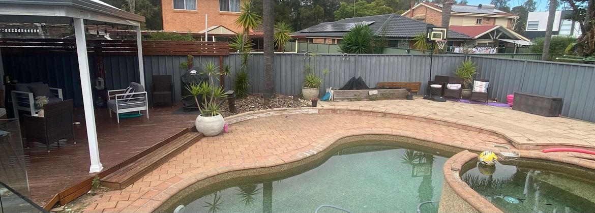

I've mocked up something. I don't want to plan it all just yet but I have grand plans and if I can complete the first part I will move on to the next phase. See the first 2 phases. We want to use composite decking. The 3rd phase would involved replacement of the old timber decking (not on pics) as well so it's a biggy!
Regarding the step between the pavers and the brown bricks level, happy to leave the step OR create a slope, OR heighten in line with the white pavers.
Wondering just where to start tho!
I have checked the council and we are good to go on the size and height of the structure.

I'd suggest a place to start might be to assess whether it is possible to remove the pavers to allow for post holes to be dug. You might like to try to gently remove a paver or two along the fence line to assess what is underneath. My concern with a deck of this size being supported by pedestal feet sitting on pavers is that it relies entirely on the pavers to support both the weight of the deck and the weight of whatever is placed on the deck. You would want to be fairly confident, especially around a pool, in the ability of the pavers to bear weight. Concreted posts are definitely the best way to go and assessing their viability might be the best place to start.
With the second phase of the deck, you might want to have an engineer assess the area as any changes near the proximity of the pool wall are likely to have some effect on it and you wouldn't want any possibility of the pool wall failing.
If you wanted to complete the first phase of the deck as a separate project, you should decide now whether you want phase 1 of your project to sit at the same height as phase 2 or you are happy to have the deck step down. Once phase 1 is completed, there's no real way for you to change the height.

Q1 - First one up is "Which paving level" is ground level? The stepped up area looks like it could be level with the fenceline ground level, the rear level looks like it has been built up?
Q2 - The brown curves are where you are thinking of the composite decking?
Q3 - Do you know why the sand has disappeared from under the pavers near the side fence?
If you put a deck over the pavers without removing them I think it may look a little high. Especially near the edge of the pool and the view you would have over the fence.
I would be tempted to remove the top level of pavers and that way give enough room for the deck to fit with a resonable step up to it. I would also figure out why the sand has gone as maybe something pipe wise for the pool is leaking and letting it run away?
As to the support for the deck I would go for a concrete stirup, mainly because the hole with the stirrup in concrete wont move as likely and that way your deck will stay solid. (compared to one of the tuff stuff deck supports)

Hi @ricm As with both @JacobZ & @Dave-1 recommendations, I would avoid using the existing pavers as the base to support the new deck. The additional weight will most likely cause the instability as they suppress in to the ground under the load. Having said that I don't think you need to pull them all up either. Instead only those 4 at each stirrup as per @Dave-1 suggestion or actual stump. Having said that the issue will be the finished height of the deck where it meets the pool over the copping that nerds to be considered, as this will be substancially higher. Sorry I'm not offering a solution, but considerations as its a complicated project.

Q1 - the 'ground' level is the brown brick tile area closest to the pool.
Q2 - yes but in general we want to have composite decking all over, we have had timber before and we wanted to try something different.
Q3 - there is a bit of history to that area, when we moved in there were 3 large palm trees and we had to hack them down because not only were they overgrown and limiting to use of the area, after much inspection by multiple plumbers, they were also the cause of crushed pipes deep down involving the main sewer line - these trees roots also managed to completely crush stormwater pipes too so they had to be totally removed and the whole area was repaired with new pipes and such. When the pavers were fitted we were warned that they might sink over time as we were putting them over the remains of the tree stumps.
Totally agree about it being too high on top of pavers, it would mean we are directly looking into all neighbour's gardens which we don't want, so I'm happy to either take ALL the pavers away (there could be a use for them on the side of the house, or just a few key pavers whatever is best and use concrete stirups as you suggest.
Regarding levels, I know the minister for home affairs (the Mrs) wants one level of deck only going from the existing decking area (to be replaced) through to the far right side, with. no dip down to the pool, however as someone noted this will make the pool very steep to get into, so Im not in favour of this, Id rather keep the levels the same (ish) and just add the new decking.
