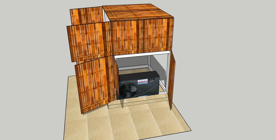

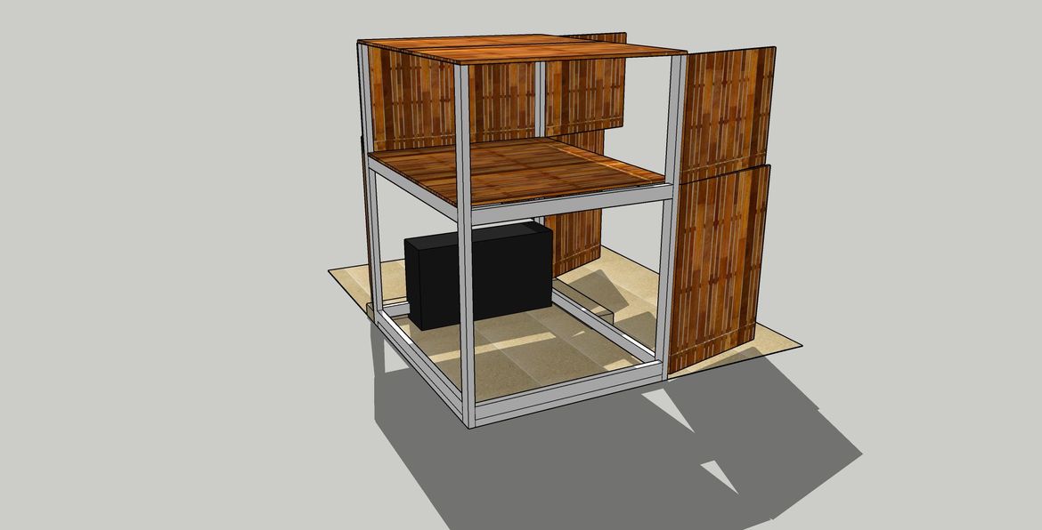

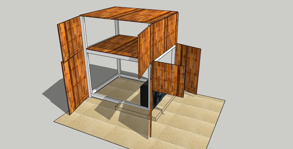

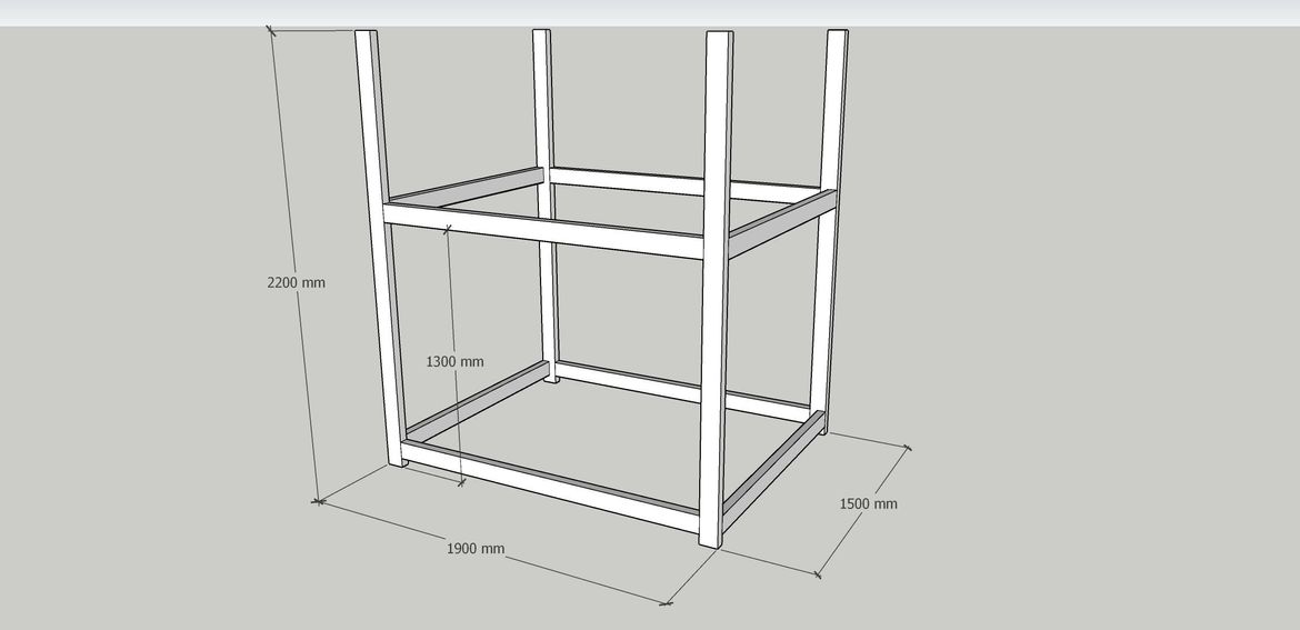

Here is an example of what your pool pump cover might look like. I've enclosed the entire set in the cover as having a cover behind your heating unit is not advisable. I've also left the front fan intake of the heating pump open so that it does not impede its performance. The top shelves are movable so that you can access any part of the pool pump. I know you were keen on sliding doors but this would have gotten in the way when servicing the pump, it's vital that all components are accessible for repair.
I suggest having a look at - 10 screening ideas for outdoor areas. This should give you some ideas on how to jazz up your fence line. I also recommend looking at - Recycled decking timber outdoor sofa by @Stuardo. There's nothing more relaxing than having somewhere to sit down and relax near the pool. Please note that the measurements indicated are for reference only, please adjust them to your needs.
