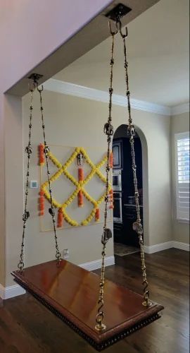

My childhood is filled with memories on swinging almost 180 degress on a swing like this outdoors. I want to build that in Australia to relive those memories and have my children exp them as well.
I want to build them outdoors. How do i go about planning for it? I am thinking of following steps
1. Dig two holes for the post (may be 60 cm or less?). Place 88mm post.
2. Attach another 88 mm post on top joining these posts.
3. Use chains to hang the swing.
Note - I want atleast 2 adults + 2 childs to swing at same time at about 140 degrees start to finish.
What post sizes do i choose?
What chains do i choose?
How to connect the chain to the top so that swing action is free?
How to connect the chain to plank?
What plank to use?
