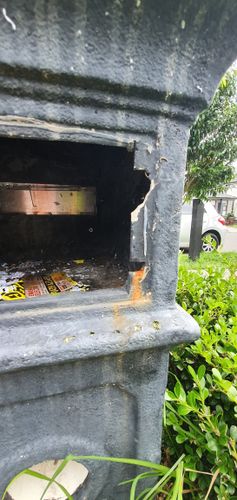

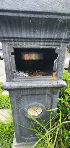

I have moved into a house and found this letterbox cover missing all my mails are either getting wet or torn into pieces by snails living inside. I have managed to unscrew the back cover and found one side on top right is broken can anyone give me tips to put a new cover with lock if possible?

What part of the current door is broken? Is it just the damage on the right of the opening that is causing the issue? Would you be able to glue the back door onto the letterbox? If you can provide some images of the door, our members might be able to offer other solutions.

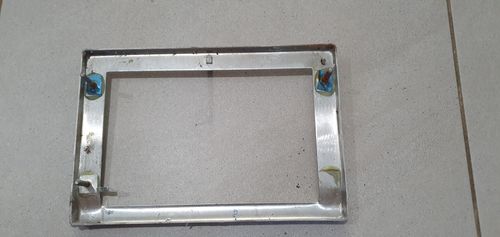

Thats the back plate ONLY. The cover is missing. I took the plate out and measured it its almost 24cm wide and 16cm long. Im happy to buy the whole set if i can only use the back plate. Please let me know if i can provide you with any further details 🙏

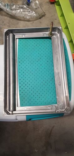

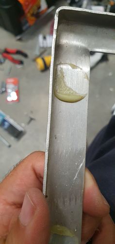

So i tried gluing it on directly but because of the weight of the cover it kept falling off after a while. Below is the selleys liquid nail i bought which i was told is more adhesive then the one you mentioned 11fc, i will have to somehow glue bolts inside first once they are holding the cover it will give better hold to the liquid nail. But to instantly hold metal bolts to metal surface i bought gorilla clear grip its still not dry but to show you what I'm upto see pics below

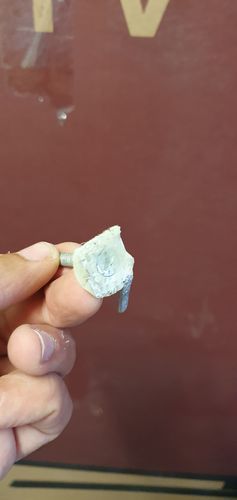

Can anyone tell me what this adhesive is on the old cover?

Hello @faisal-s
I can't identify the original glue that was used on your mailbox door, but I suggest using Selleys Liquid Nails Instant Hold. It has a horizontal weight rating of 5kg on metal to metal adhesion. Please note that you must let the adhesive cure for at least 48 hours before you use it. If the weather is too humid or it is raining please add one extra day so that the glue will cure to full strength.
If you use it too early the glue will fail and you'll have to do it all over again. I recommend being generous with the amount of glue you will be putting on to make sure it covers the head of the bolt.
Let me tag our experienced members @TedBear @Noyade and @diy_hausdesigns for their recommendations.

Sorry, I'm not grasping the problem.
That frame above is stainless steel or aluminium?
One attachment bolt is missing?
The rest are spot welded?
But you have all the other hardware - door and lock?
