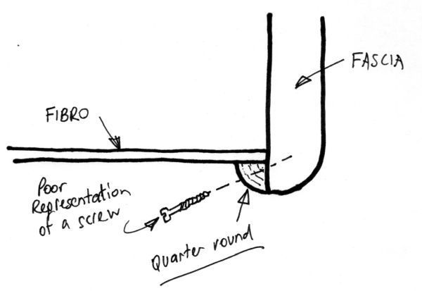

I would imagine the fascia board is screwed into a frame behind it, could we possibly send some screws straight up where it has dropped on the edge fixing it into that?
Could you screw/nail a length or quarter round into the fascia back - to support the fibro?

Yes, thank you so much. I believe it may work, because my front eave have the quarter round this way - but not sure why back yard doesn't have it. but no crew in. not sure how to stay with fascia.
