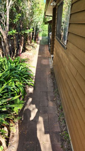

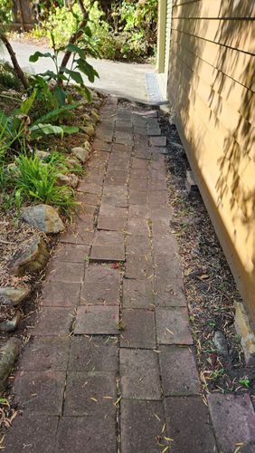

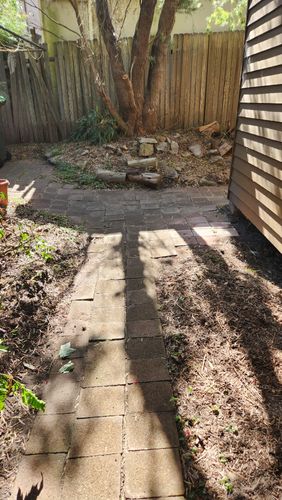

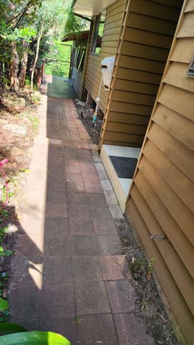

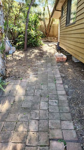

Hello there - we have 2 x pretty hideously looking side passages with uneven pavers that could do with an upgrade.
Any idea on how to make the space better without breaking the bank whilst also minimising weeds?
Thanks!!

Looking at the pavers it seems that there are a few different sizes/types you have?
First step I would lift the pavers and then put them down level again (paths always becoem uneven with time, well some do 🙂 )
Now before you put them immediatly back down, how about reconfiguring them to have a pattern in the pathways? So down the center use the rectangular pavers, then say two squares width either side. To dress it up you could have a hard edge to the path, either the concrete edging from Bunnings Custom Concrete Products 900mm Straight Tapered Garden Edge There is also a shorter version..
You could also go the route of some hardwood or treated timber as an edge (I prefer hardwood as it just seems to last longer, I have used old fence railings for edges and they are still there after 5 years.) I have also used 8mm gravel I had left over to set pavers on for my pathways and it has worked a treat.
To smarten up the sides, you could put in some kind of lattice or bambo timber covering for under the house Outside bench is where I used some to cover up the not so nice a view.
You could also go the route of some gabion seats with timber tops, They are pre packed and ready to go gabion basket unless you want to make your own as I did Gabion wall bench seats down the side of your path.
Last part of the question was "get rid of the weeds" The eternal question... I would suggest mulching and more mulching plus ground cover that stays low. I dont like using weedmat as I have tried it and the soil never seems to get wet underneath as easily. It stops the soil drying out but "arms in a shrug" If you have a look around where you live you may find some ground covers you like the look of and you know that they will grow in your area. I am forever taking photos of plants that may make the grade.
One last look at your photos and must say I love the trees, Id be making them the feature in the revamped side yards, Shining light up into the underside of the leave sand the plavce will glow is just one idea, plus mulch... 🙂
