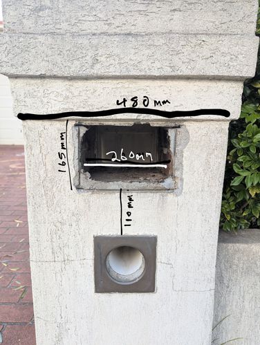

Hi, I need to replace my letter box I got home from work today and found the front of my letter box had been ripped off the measurements are roughly W 260mm x H 165mm x L 355mm just need some advice if there is a product that can fit in the hole.

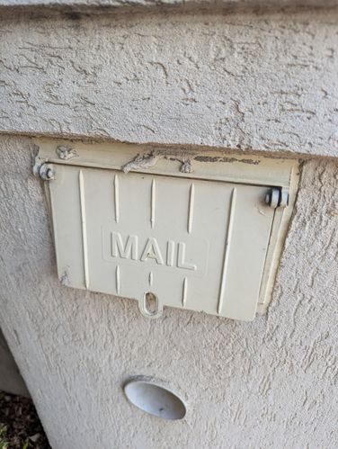

Ugh 😕 Feel your pain. I was trying to figure a way around or see if you can possibly buy a new front panel. I didnt find anything that I felt suited. Until I came across this Bunnings thread from 2022
By @faisal-s
On How to fix or replace back cover for letterbox?
Now I know this is the rear door of a letterbox but it may help you as a starting point.
Will tag a couple of other members including @Noyade who may remember the thread?

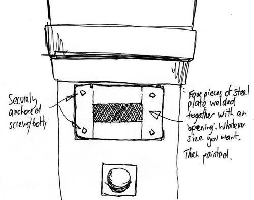

G'day @rhys1
To my eyes it looks like the front was 'pressed' into the mortar - hence easy for the vandal/s to remove?
My thought was welded steel plate leaving an opening for letters and small parcels. A lot of openings these days are too small for the modern World (eBay/Amazon).
And make it large so that the anchoring points are well away from the opening and covering the damaged mortar. Silicone at the top and paint.
Just a post coffee thought. Either way, I hope you get it sorted.
Cheers.

Morning @rhys1
I'm more than happy to put something together and 'post' it to you - no cost.
We just need some accurate dimensions. Let me know if you're interested. 😁

That sounds great thank you, I will send you some pictures of the measurements and then you can do what you need to do. I will include my address with the pictures hopefully the postie can find the place to deliver it as I don't have a post box lol will update later after work. Thanks again.
1. The width of the post is 480mm
2. The height from the top of the letter box hole to the bottom of the letter box hole is 165mm
3. The inside brick to brick is 260mm
4. From the bottom of the letter box hole down is 110mm (not sure if you need that measurement but I've added it)
Hope that helps.
If you need any more info let me know thx again.
