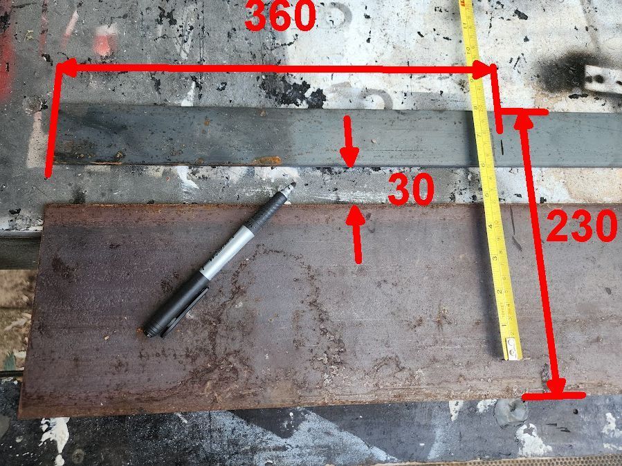

@JoeAzza has provided a link to a letterbox front which I did see earlier today whilst googling - it's 235 mm wide. If your 260 mm dimension is accurate - then too small?
Below is the 'solution' I have. Don't be put off by the steel appearance - I can grind and burnish it after welding.
The big question is - how big a letter opening do you want? Below is 30 mm and I'm assuming the letter opening needs to be located high on the plate.
The other question is - do you want to drill the anchor holes? I'm not sure by your photo where the brick 'meat' is and the mortar is.
Let me know what you think.

I measured 260mm inside the cavity from brick to brick to the other side not sure how thick the bricks are, I will probably have to drill the anchor holes myself and try to work out how much meat is on eather side. 30mm looks good.

OK - thanks @rhys1
I'll probably weld this up on Sunday - and I'll show you how it looks.
The plate is 5 mm thick.
Please feel free to say yes or no to the finished product.

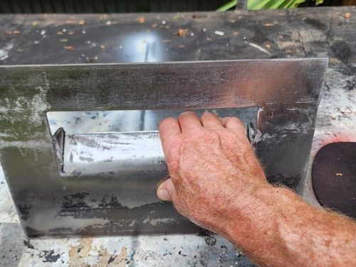

Progress.
I added an inward 'lip' - which now gives your postman around 50 mm thickness in mail that can be inserted.
Pretty much done.
I was just gonna spray paint it white, but you may have other ideas?
Your's if you still want it - just let me know.
Couldn't stop myself - @rhys1  - I went with white...

Wow Looks great 👍 thx again, the wife's likes it.
