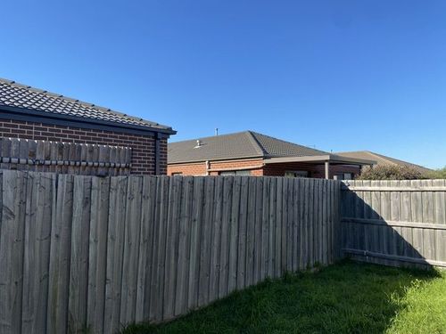

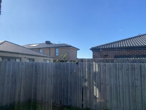

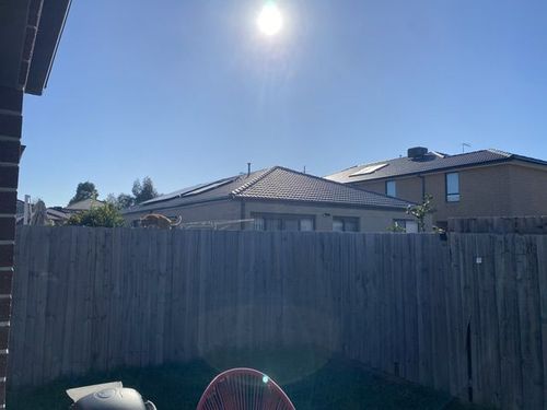

I want to block from the neighbour’s bamboo fence but to the left hand corner and then along some more
the back neighbour has put this bamboo screen thing up on his side as he has got a raised deck along the fence which makes it easier for him to see in to us on either side of it…I want to block to the end of our fence line
I want to block the corner bit on the right, and also along the LH side to where the cat is

I’m looking for some advice on how I can screen out some very nosey neighbours, immediately!! I am so sick of them looking into our kitchen!
Our council area doesn’t permit us to attach anything to our fence so a fence extension is out of the question!
I don’t want to bother with plants as these will take too long to grow and I need a solution for spring.
It’s basically 2 corners that I am trying to screen out - about 3-4 meters on each. Our fence is 1.8m high.
I’ve looked at the whole bamboo/brushwood screening stuff but that’ll require me to attach it to the fence which I can’t!
I was looking at installing some wooden posts and concreting them in and attaching like some bamboo slatted screening to the posts so it is independent of the fence.
I need to do it on a very very tight budget eg less than $200 so my options are rather limited!
Just hoping someone might have a solution? Or have another cost effective way to solve this dilemma!

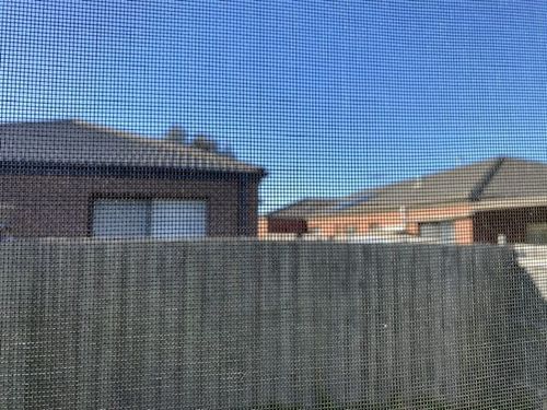

Thanks Jason! That’s a good idea and might be worth considering! The only thing is, the back neighbour can still see into our garden when we’re in it as he has got a raised deck…

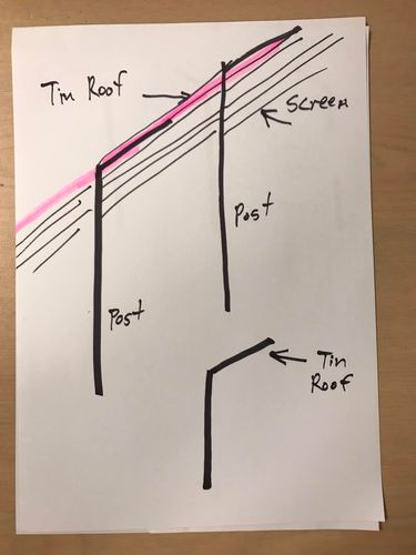

The solution I have planned are 2.5m vertical posts along the back fenceline spaced every 1.8m ish. The top 500mm of these will have an angled arm facing back into the yard. The overall height is increased without the neighbours feeling there is a solid wall there.
I walked around the yard trying to figure out how to block without blocking. This seemed to be an idea. I also could string wire to grow vines later if I wished.

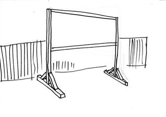

I have similar thoughts as above - but maybe produce a mobile volleyball net style of sight barrier - just to begin with, so you can experiment with 'line of sight' and it may be cheaper as you don't need screening below the fence height. If satisfied, bury the posts and make it permanent?
Just a one wine glass thought.

@Dave-1 can I ask what you are using for the screening on the angled parts. I have a similar idea but am going to use catnet fence brackets. Just trying to figure out the screening. Thank you.
