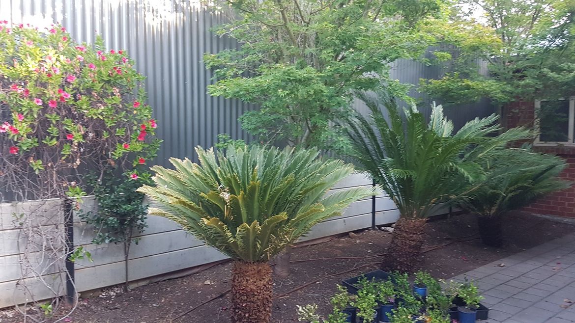

@HassanKhan28
Are you sure you need to go to the trouble of screening it off? It looks like your fence is in great condition and could just be softened by planting a little more or doing something like this - https://www.workshop.com.au/t5/Garden/Climbers-to-dress-up-Colorbond-fence/m-p/18390#M2315
And your retaining walls also look very solid but perhaps just in need of a paint?
I reckon a combination of paint and some gardening would give you a brilliant result.
