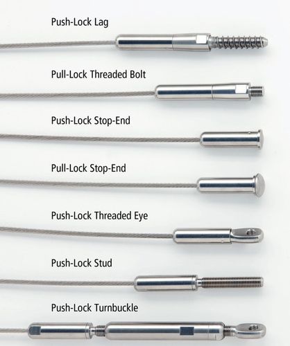

A couple of questions for anyone with experience in wire balustrades.. I don't want to buy the kits from Bunnings, because it works at way too expensive, but there are other suppliers (such as http://www.hammersmith.com.au, and http://www.allthingsstainless.com.au), who have multiple different 'systems', where you buy each part separately..
Owing to the fact that the deck is pretty small, i'd like to use a system with small fittings (ie: so that the length of wire is not dominated by a large turnbuckle, and large fittings at each end)..
Any suggestions?
