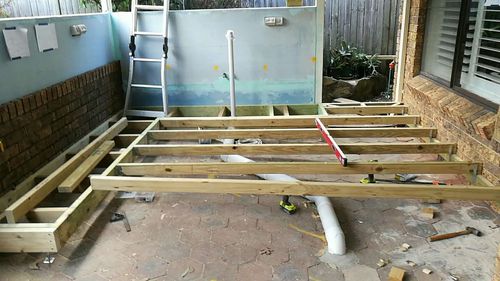

I have been thinking of upgrade my backyard entertainment area and build a outdoor BBQ kitchen for quite some time, last year I finally decided to put it in action.
Things have been done so far:
- Upgraded pergola roof to better heat resistaint sheets, it is now much more comfortable during a hot summer day.
- Upgraded the lightling and installed a ceilin fan, it worked very well during last Christmas.
- Did the plumbing work including both hot and cold water pipes and drain pipe which connected to the existing kitchen drain.
- Built the half wall for the kitchen area
To be done
- Build a decking floor across the entire pergola area
- Build kitchen cupboard and building BBQ and Wok Burner
Chellenges
- In oder to ensure the new decking floor is not higher than the house floor, the whole decking is very close to the ground. The lowest point is only about 90mm from paving surface to the top of joist. I am using 70mm timber for the joist support system.
Anyone has any suggestions and/or previous experiences, I'd love to hear. Thank you.
