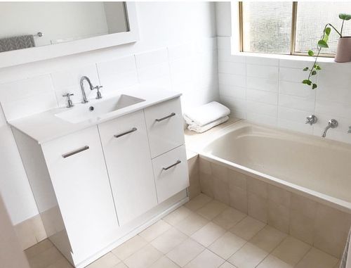

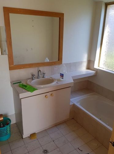

Ah I see. You could probably get away with it by choosing the right laminate or spending a bit more on engineered floorboards, ie. a contrasting colour, something deliberately different. But I'll leave that one with you. I like @Kermit's suggestion of seeing if there are boards underneath.
Personally, I'd be doing floor to ceiling on all walls including replacing the existing. It's a cheap but very effective and worthwhile way to go. Look at the difference it made here and I didn't even do floor to ceiling or the sides of the tub (time constraints as the house needed to sell and there was a huge amount of work to be done).

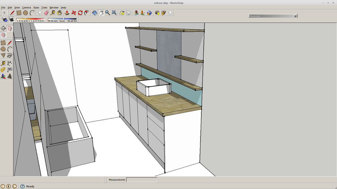

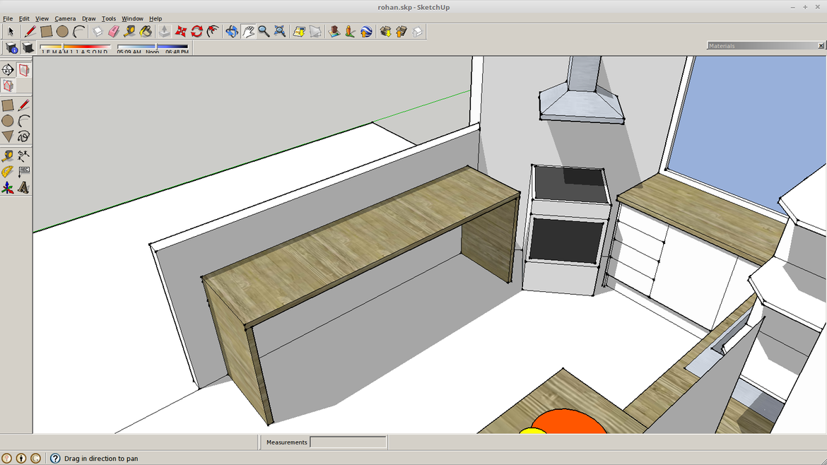

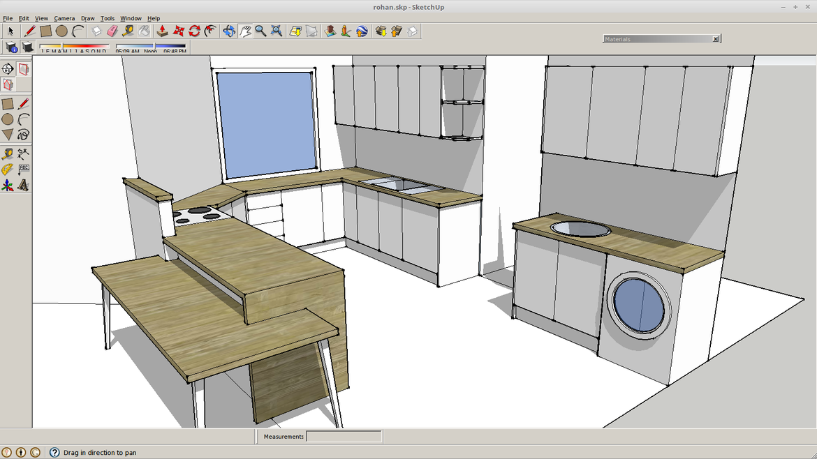

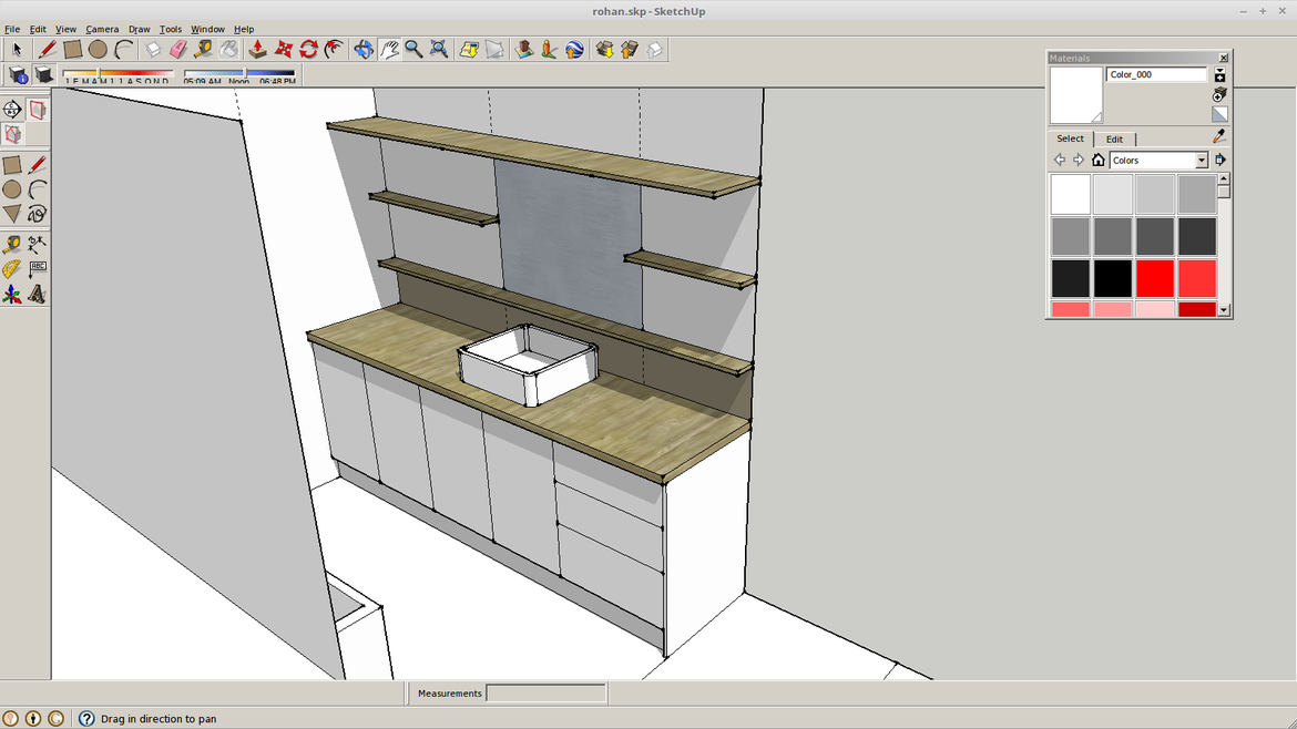

Hello RohanH,
Here is a preview of some of my suggestions. As you know I only do my drawings in the evenings to relax and unwind. My apologies if the rest of the drawings come in slowly. Please note that the drawings are not to measure and are for generating ideas only.
1. How about we move the laundry out and give it a London apartment feel?
2. Give the shower area a proper storage/vanity area.
3. Tear down the wall separating kitchen and living room, close off the oven nook and move cooktop to the other side.
Tell me your thoughts and I will incorporate them in my next drawing. Cheers!
Massive storage for towels and stuff, you can never have enough shelves.Massive storage for towels and stuff, you can never have enough shelves.I suggest LED strip lighting under the bottom shelf and top shelf as alternative to harsh mirror lighting.I suggest LED strip lighting under the bottom shelf and top shelf as alternative to harsh mirror lighting.Washing machine outside, laundry tub on benchtop, steel square laundry tub sold on gumtree.Washing machine outside, laundry tub on benchtop, steel square laundry tub sold on gumtree.Corner cavity covered up with plaster, cooktop moved over. New breakfast area ready!Corner cavity covered up with plaster, cooktop moved over. New breakfast area ready!New meal area! All the benchtop area you could ask for!New meal area! All the benchtop area you could ask for!

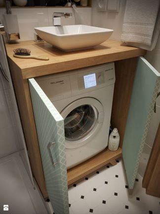

I'd prefer to keep the washing machine out of the kitchen - possibly in the area where the current vanity is, somehow combined with a sink, like this:

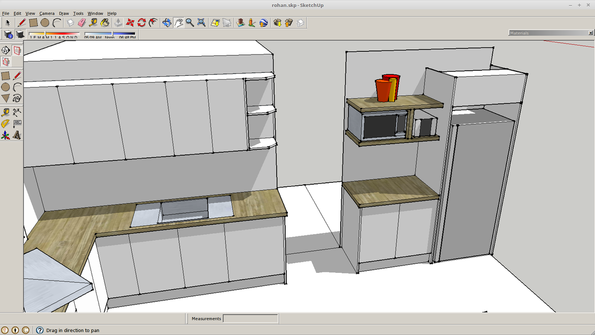

Hello Rohan,

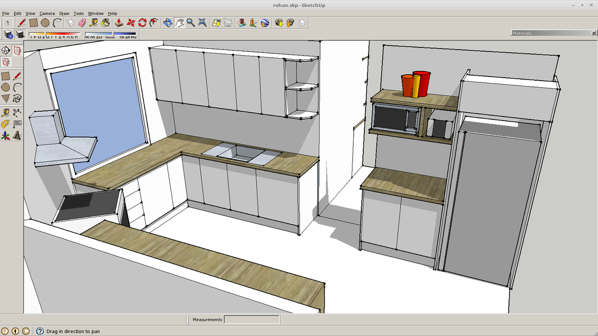

As requested. Here is your revised fridge/microwave area. I have placed the microwave at the same height as a standard wall cabinet. The distance is 600mm from the top of the benchtop to the bottom of the microwave shelf. You can adjust this if the microwave proves to be to high to reach. Next to the microwave is the toaster. I used the bench top material as your shelves as it gives it that beefier look and ties in nicely with your new breakfast table. I've also drawn your standing oven/cooktop however I leave the choice to you if you wish to cover the cavity and move the appliance forward or leave it in place and just add a rangehood and duct it into the existing exhaust. Moving this appliance will block your drawers on your existing kitchen so you may want to have a think how you wish to proceed. I purposely did not draw the dividing wall so that you can see the room better.
Your washing machine under vanity basin will follow soon. Cheers!
___I only had enough coin left to buy you a vase above your microwaveI only had enough coin left to buy you a vase above your microwaveMaybe some ceramic dolphins from daiso?Maybe some ceramic dolphins from daiso?Timber bench tops give a kitchen a warm natural feel.Timber bench tops give a kitchen a warm natural feel.
