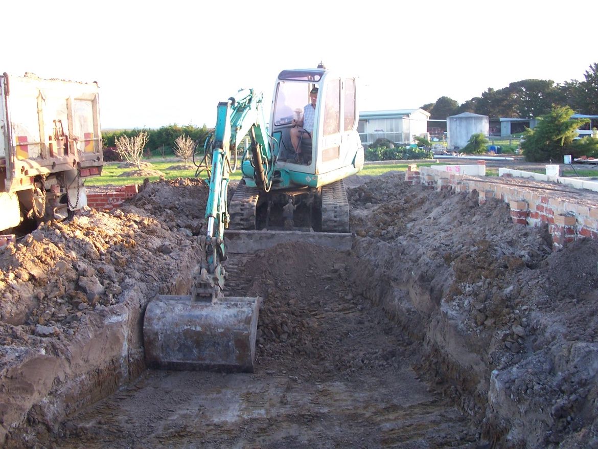

First photo shows the pool hole being dug, something that had to be done well before much else could be done with the construction.

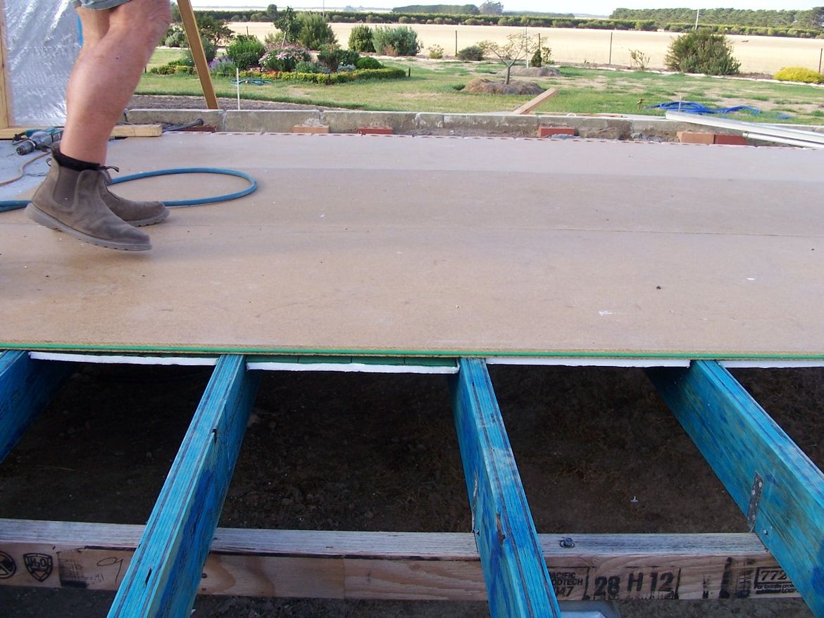

Second photo shows standard clay bricks used to build up the foundations to the required height for both the house and veranda.
We decided early on, that we would not have timber veranda's for maintenence reasons, so the 3rd picture shows 90mm poly pipe at 5mtr intervals for ventilation under the home.
Fourth pic shows the stumps and we used LVL bearers that were 6mtrs long and the 5th photo shows the LVL's that were 12.5 mtrs long.

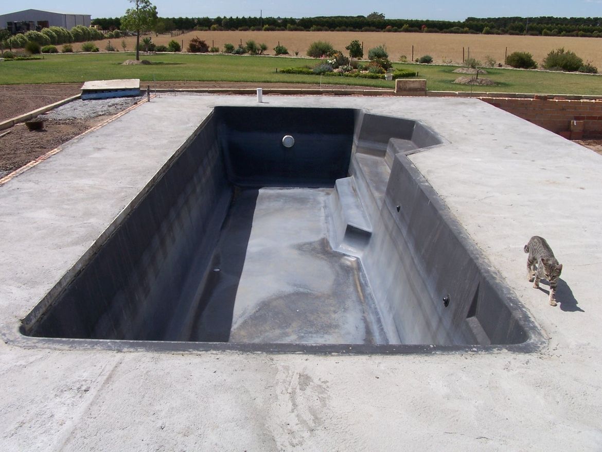

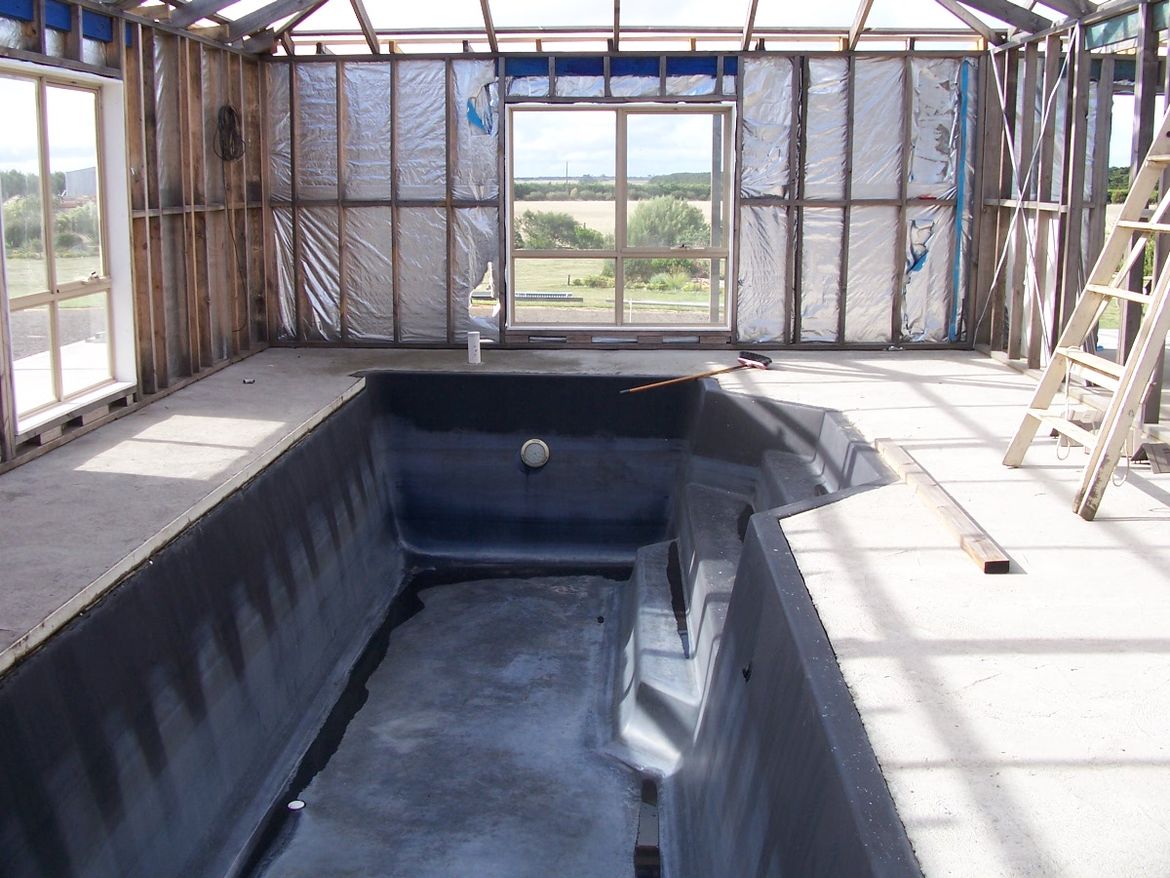

Well thought I'd add a little more to this topic, pretty cold day here today as I think it is almost everywhere with predicted hailstones.
Next photo in the build I have attached, shows completed pool prior to framing with my  offsider site manager Pipi checking the process as usual!
Next photo is a notherly view from the pool with framing going up.Pool Concrete Finished no 5.jpg

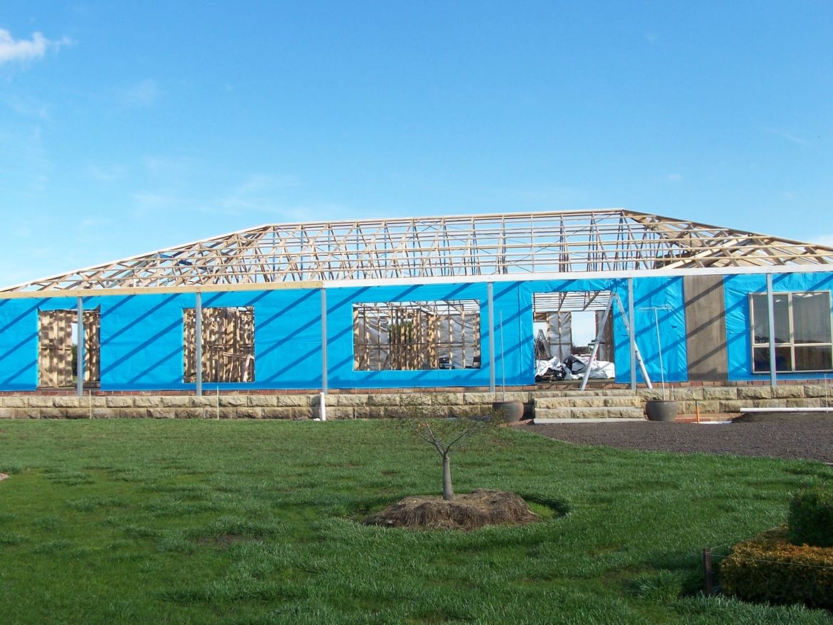

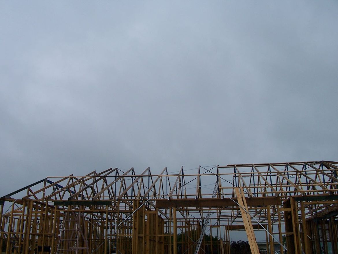

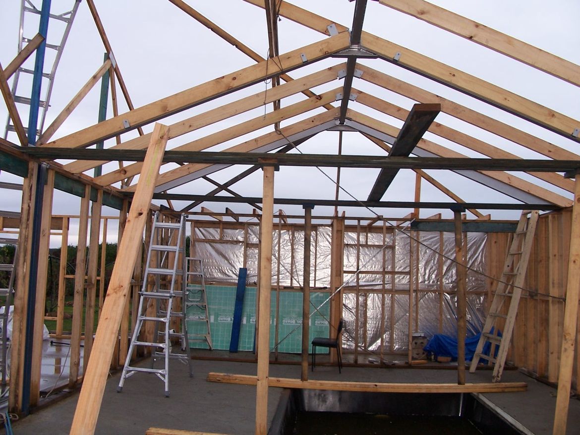

Picture above shows framing in full swing and then came the trusses in the picture below. This part of the project was in my opinion the most challenging of anything else we've done on the home thus far.
The trusses were 12.5m wide with only the slightest overhang on the top plates of I think was only about 10cm or so. To pick the trusses up, we fastened two 8" x2" timbers in old measurements, in the main triangle section of the trusses so as not to compromise the gangnails, we then lifted them up with the trusty front end loader and sat the truss on the east end of the house. Then we fastened a rope at either end of the trusses and we dragged the it from the east to the west, some 17 mtrs initially, lifting or jumping it over the odd gangnail that was in the top plate here and there, until it was right up the west end and ready to stand up. Then we used a long board to start to lift the truss and took up the slack with two ropes fastened at the centre or top of the truss, one rope pulling east and the other west. Slowly aand painstakingly, we loosened one rope and tightened the other rope and mostly we succeeded with each truss, although the odd one slipped off the top plate and we had to re lower the truss, lift it back up onto the top plate by hand and start the lift again. To get the truss back up on the top plate, we had to completely skew the truss, even though we only had to gain that small amount of 10cm.
Fourteen trusses later and we had them up and then there were the smaller hip trusses but they seemed rather easy compared to the main trusses!!!Trusses no 1.JPG

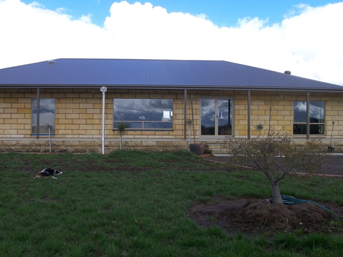

First is the north side of the home, can't get a panoramic of the whole area, little camera won't do it at the house is 26.1mtrs long but it's almost all there together with the dog in the process of killing her rope toy as she regularly does by rolling on it, after attempting to shake it to death and not being successful ha-ha

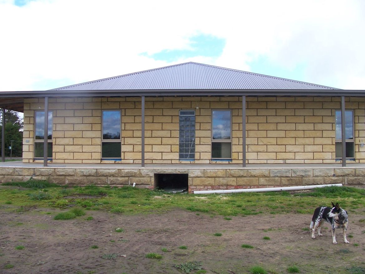

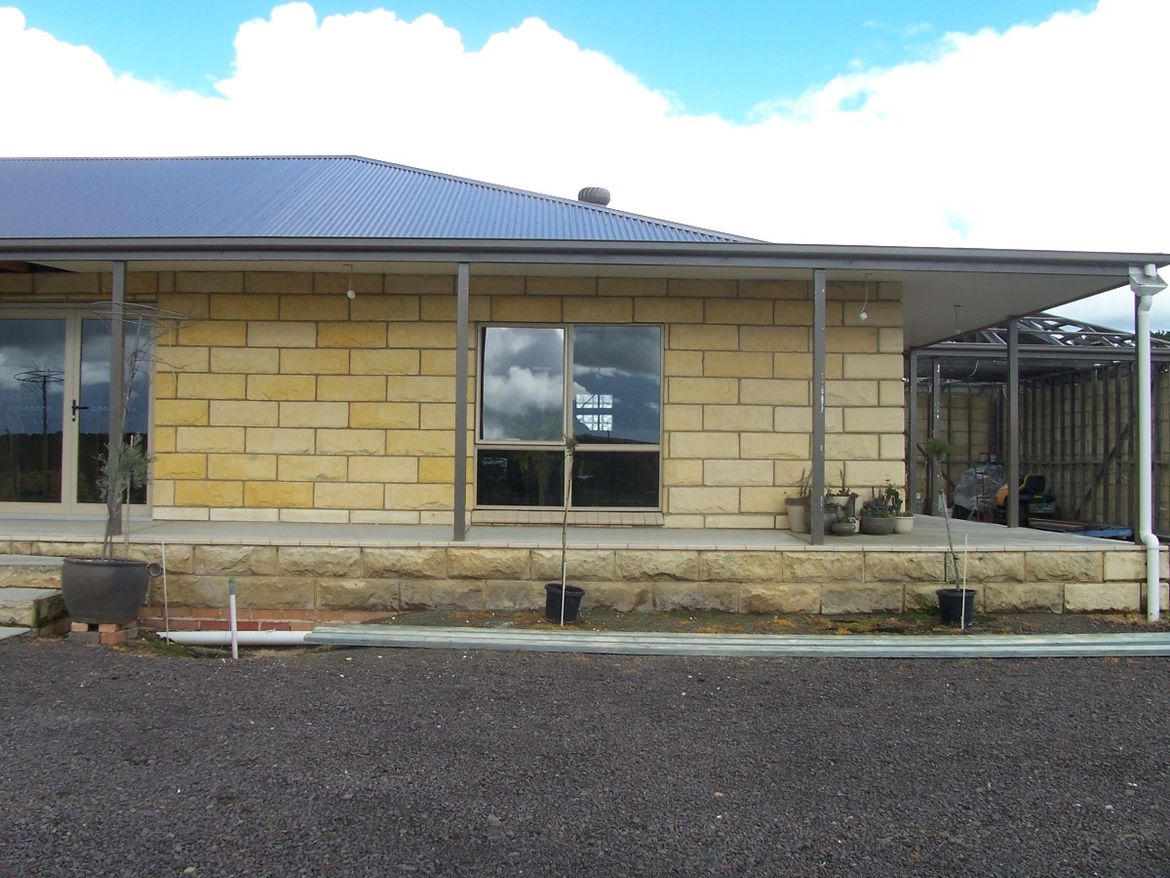

Next two photo's show the south side of the home, first one is taken more to the west showing the glass brick windows in the indoor pool room, back door, lounge window and the all important invalid access ramp having been mindful during the build to make provision for such access both into the home with minimal height door sills and also including interior features such as a stepless shower, full sized invalid toilet and 870mm doorways.
Next photo shows the south side photo taken more to the east showing laundry door and bathroom with the glass bricks.

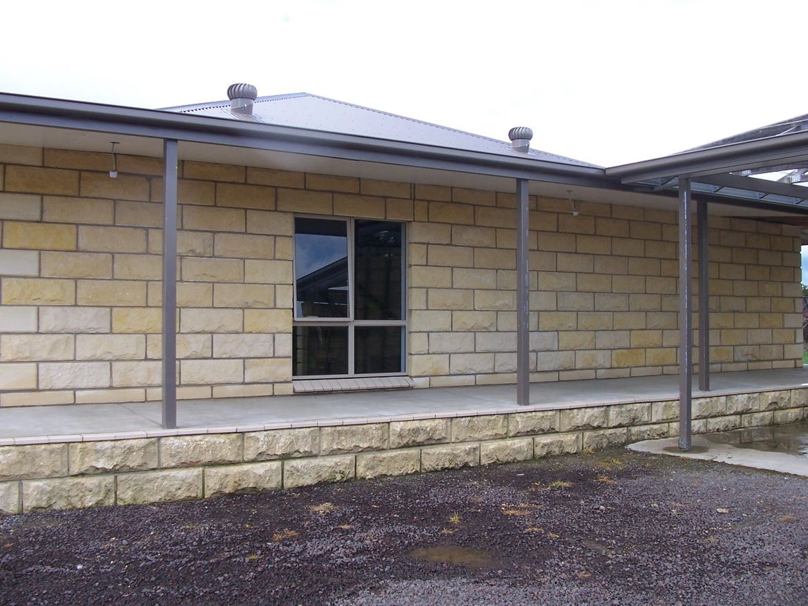

Next photo is the east side with master bedroom to the right of the photo, 2nd bedroom to the left and toilet in the middle with glass bricks again to create a nice look of what is effectively the toilet, as I hate the usual windows that are used in toilets that cannot be mistaken for anything else. Allows for this side of the house to still be attractive!!
Note the manhole for underhouse access, again my idea instead of having to have a floor trap somewhere in the home and imagine having to take a length of pipe under there for a repair or addition for example. This manhole when the area is complete will have an access door and with the house running longways on entry, access with anything will be a breeze.

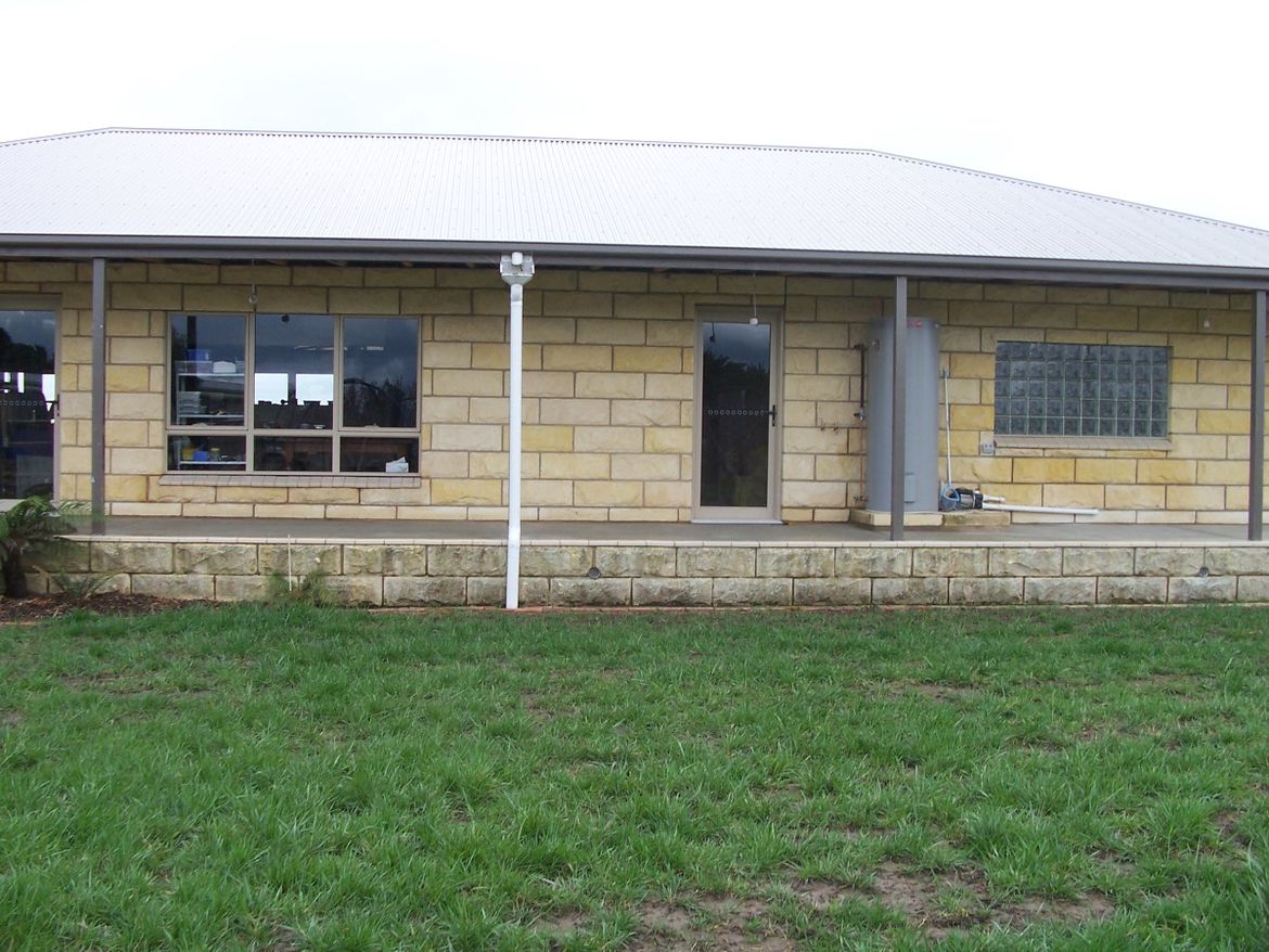

First photo below is the west side or pool side with the carport just out of view but to the right of the photo and the second pic shows the front of the indoor pool on the north west corner with the front doors just to the left of the photo.
