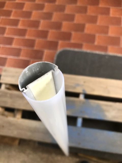

Have you considered using extruded clear acrylic half round strips or spiral if you are in melb I can give you a few places I have delt with on the other hand you could buy a bunch of 3ft LED tube lights pull them apart and use the tub and defuser. I have a old tube pulled apart which I will post a photo shortly
to link the tubes get clear acrylic tube extrusion cut a spacer to link all the tubes together

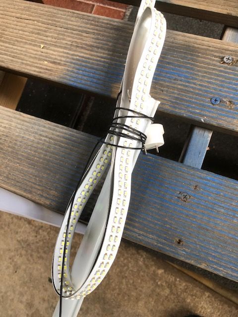

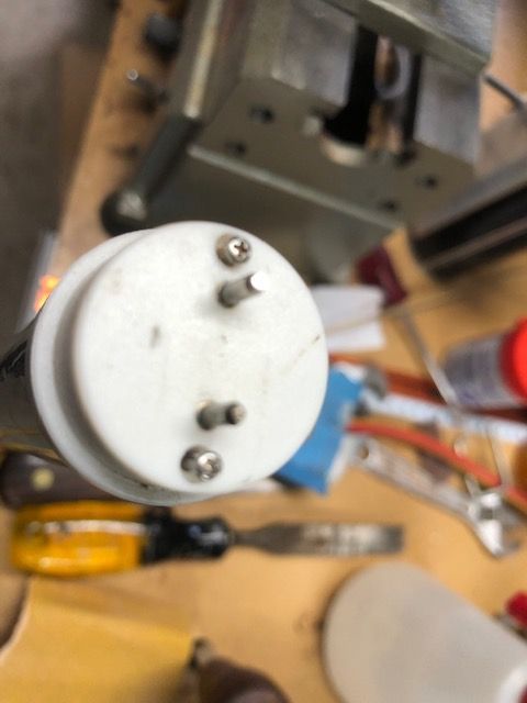

I have striped down an 3ft LED tub
The aluminium section can be used as the heat sink as it is for the tube. when the LED's are striped you left with a glue which can be used to hold the LED tap in place to the heat sink then slide the defused back on then it up to you how to hold it in place.
the other method could be use c channel lat the LED tape in it and place the clear acrylic over the top.

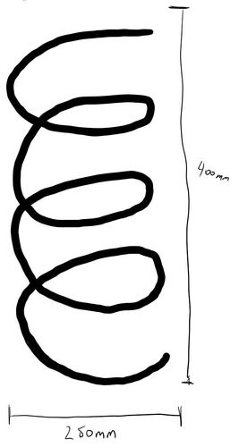

Apologies for the super basic drawing, however i would describe it as a spring coil, but maybe 15-20mm thick. so i can hide the LED strip on it.
To hide the strip, i would like to make another one to act as a backing or second skin and then have it bolted together at the top using threaded rod.
