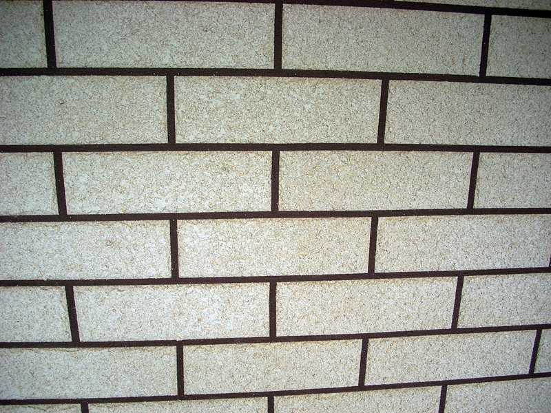

Now for the square/rectangular air con hole. Is the outside cladding a weatherboard style, or single sheets where you want to make the opening?
What size opening do you need to make?
Are there any elecrical cables in that area?
The outside cladding looks like brick but it's just a raised shape on what looks like fibre cement..
I've just recently bought this place and I've never seen this type of panelling before...
The cutout for the aircon. will be approx.450mm. x 320mm..
There aren't any cables in the way...
@Prof, I'm hoping that your home is post 2003, & the fake brick is from this Aussie manufacturer, check them out:
If that doesn't look to be it, then I ask, do you know how old the house is?
Or, could you send a photo of the faux brick cladding?
No it doesn't look like that one..I'll take a photo and post it here..
The whole panel is approx.10mm thick and it has Hardie on the back...
