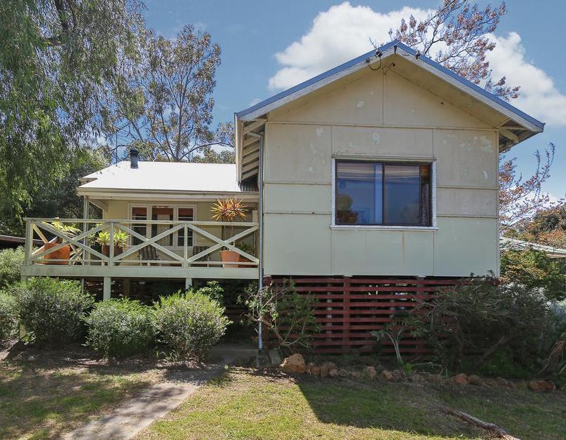

Are you able to share a photo of the house? I would think that if you are wanting a relatively cheap and easy way to improve the street appeal of the house then painting would be a great option. You might also be able to do simple things like window furnishings and some planting to make a big difference.

Many thanks for your post. Yes, maybe painting the house will end up the easiest solution. There are 2 layers of paint on the house, unfortunately, the top coat is flaking in places and, where it's flaking it comes away easily but, where it's not flaking it's okay, which means that I have these patches that are different levels, if you follow what I mean... the original paint and then the yellow coat. I tried sanding down a small area but it still leaves visible indentations... that is, the difference between the thickness of the 2 coats. Maybe a thick coat of paint would cover those peeled-off areas, I'll have to check what suitable paints Bunnings has in store. I've attached a photo as requested... cheers, John

Hi @Hansi have you thought of external textured paint. There are many types out there and can be applied a number of ways eg roller, spray or hand mit. Give the look of a bagged wall. There is a great range at Bunnings with some great advie

Thanks Stephen, yes, I think that I'll nip down to Bunnings and have a chat to see what paints they have... I hadn't thought of a textured paint, that sounds as if it would cover a lot of the blemishes, etc.!
