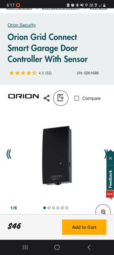

So for the garage door Orion Grid Connect to a great little unit
Fairly easy to install and the instructions are good, the inputs go into the OSC and COM terminal of the motor and then a fixed wire runs down to the door in closed position to create a strike contact. I have posted on this as Eric has linked in his reply.

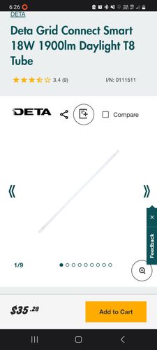

For the light tubes you should be able to change them over to the arlec grid connect 4ft LED smart tubes, the only drawback is they may not work on electronic ballast fittings (those without starters) but check the packaging.

The other good thing with the garage remote is you can see the up/down position from anywhere in the world and control it too. You can get notifications if it is open for to long.
You can get a notification when it is opened.
If you connect Grid Connect to Google Assistant you can activate opening the door through Google voice command along with a pin code very handy in the car if you have Android Auto.

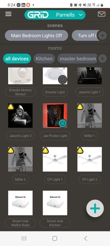

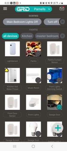

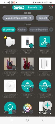

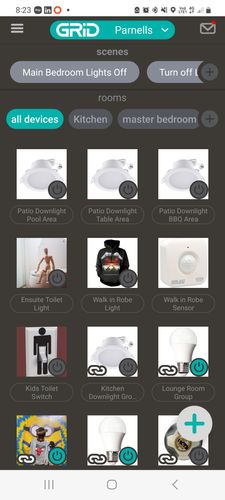

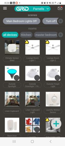

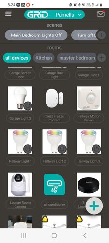

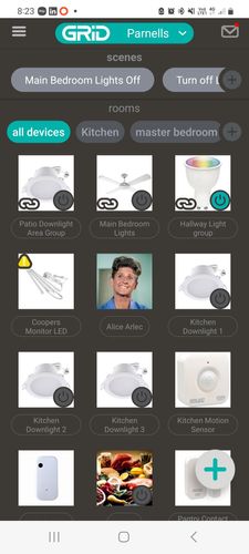

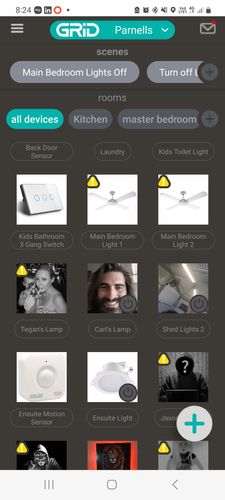

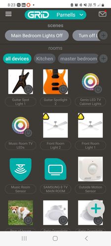

@bennyboy I started off with a 3 pack of BC globes and now look where I am at
And my scenes (Automations) are way to may to image capture.
