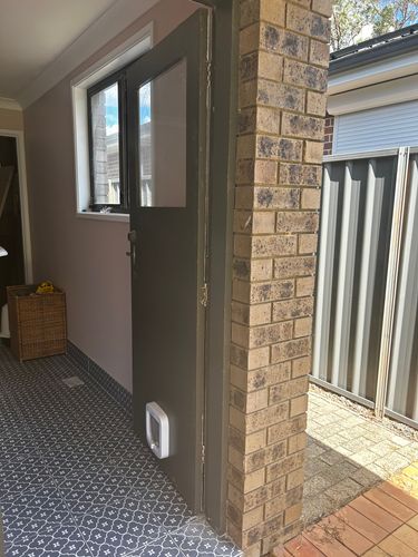

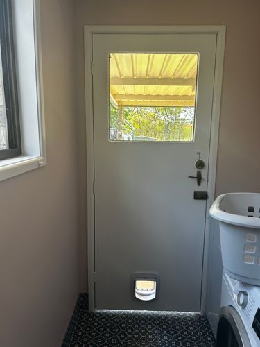

Due to having a super skinny laundry room, I’m having order cabinets that go over the door frame and block the door. My solution to this is to change the door from opening onwards to opening outwards.
Can someone please explain how I go about this?

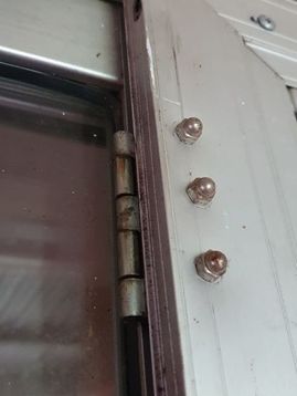

Thank you for sharing your question about switching the direction of your door. For internal doors it would not be so hard, but for external doors not only is it difficult but it makes your door unsafe. You will notice that your hinges are on the inside of your door, this prevents the hinge pin from being removed. But once it is outside the hinge pin can easily be removed which will allow your door to be removed and people to enter.

I'm going to rock the boat @Kyliecjr, and say that it's possible. Fixed pin hinges are available, so that really overrides concerns about the pin being removed if it's on the exterior. It's then just a case of whether the door jamb can be changed, and this is entirely possible, especially if you employ the services of a carpenter. If this were my door, I wouldn't be replacing the whole surrounding jamb but cutting the jamb section that the door closes against off, and installing a new timber section on the opposite side. However, a carpenter might advise that pulling the whole door jamb out and flipping it would be quicker.
